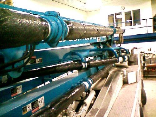

| sgt580 | 12-12-2008 | comment profile send pm notify |
used some old concrete blankets, zip ties and black duct tape !!! Cheap and works great! I pumped in single digit temps today and waited 30 min for a balance to be delivered with no probs. |
| Todd | 12-12-2008 | reply profile send pm notify |
Very nice, very clean looking, good job. |
| Bob | 12-12-2008 | reply profile send pm notify |
You did a very slick job. It looks good! Most of the blankets I have seen are filled with open cell foam that will absorb water. Once the foam gets wet it looses its ability to insulate. The other thing about the wet foam is the weight. Just a thought ;~) |

| sgt580 | 12-13-2008 | reply profile send pm notify |
Contractors build tents and use heaters to thaw the ground for footings and heat the forms in the same manner before we pour. Thenn they blanket it to retain the heat until set up. Its alot more work but the customer pays more for construction in the winter. Freezing in the boom only occurs when you stop moving the mud like when moving or waiting for the crew who might stop you to catch up or something. In single digit temps and below you boom will freeze up quicker than 2% NC on a hot summer day. |
