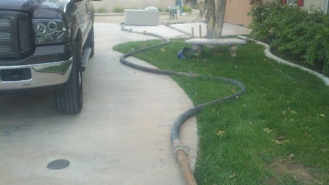

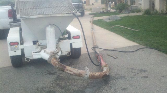

I'm new to line pumping,owned a telebelt for years. Is that 2 1/2" or 3". just less pressure using those 2 90's off the back rather than rubber? do you water wash from your pump or use air? Thanks Terry
biged 11-03-2011
Even with the surge chamber you still get a little kick so the way you are doing that its put a lot of strain on you manifold you should always use rubber first then switch over to steel one day before long you will unstand my thinking when your manifold has a crack in it.
Crete you need to worry about 2 1/2 inch hose as your biggest size, I have been line pumping for 5 years and have been pulgged many time but they are getting fewer these day no your mix designs and demand them from the supplyer or walk away.

Thats why I like running my Trailer . I just put it in 2nd or 3rd gear and I get no kick at all.
I personally dont like running a rubber hose off the rear of the trailer, because there is a lot of pressure pushing out trying to go around a bend. In my opinion, its always better to run steel first then rubber. Plus, when cleaning out, if you have rubber for elbows the pig gets stuck sometimes.
How do you guys prime? I use one 94LB bag of portland usually.. If its grout, I just use water in front of it.. If its a long line job, I usually stick a ball infront of the prime to help it coat it evenly..
I remember my second line job I did I tried to prime in reverse.. LOL that didnt end up good. I had to break the 4 to 3 off and pump two 5 gallon buckets worth of stone out, spray the 3" hoses with water, hook er' back up and jam it through the rest.
You live and learn I guess. hahaha
Heres a picture of the job I was on Thursday.. I had a loose fitting that I found too. Luckily I had some oil soaks to catch it! as you can see I used a 90, then 5 to 4, 4 to 3. Like I said I never use hose of the back.
I suppose it just depends on the pumpkit it has too. This Schwing has a BP1000.
trailer
