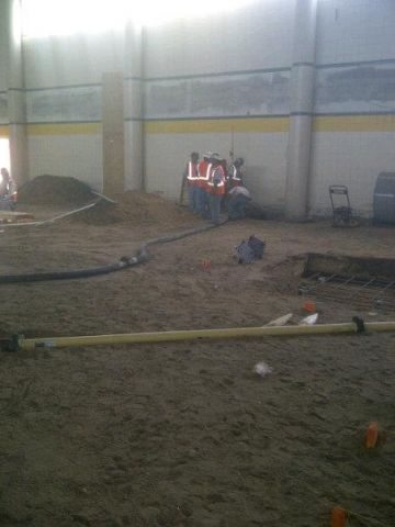

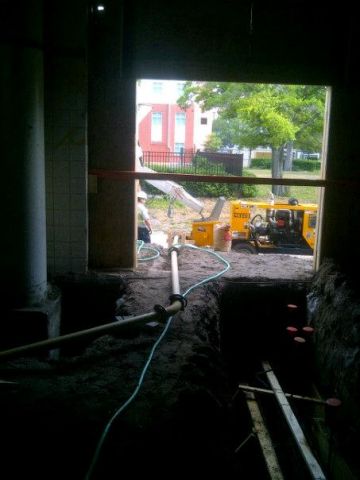

We tested out some 3" hard lind today at University of South Florida with our A40HP Reed. Having never used hard line, it was a simple as pie, once I found the back ally we were working in. I figured 21.6 yards an hour which included time spent dragging the 3" end hose around from footer to footer. A straight pour, slab on grade which we should do here in a few weeks, I would bet it should be 30+ yards an hour. If my hopper was big enough for 2 trucks to fit, that number might go up a bit. We ended up buying the pipe on the spot. We are waiting for the brand new end hoses and clamps, but we have the hard line on the job site. I found it a bit challanging to get just in the right spot for the line, but I just have a huge truck and was working with inches of space. We did prime differentlly though. We used a double slick pack, with 3 buckets of a portland slurry. Worked great except one of the borrowed end hoses was plugged with something. A quick change out of hoses and off we went. We coated the pipe with a thin coating of Hyd, oil to keep it from rusting. While I worked 13 hours on about 2 hours of sleep, Today was pretty easy. The crew of guy I worked with actually knew what they were doing. They had the clamps lubed and everything set up quickly. They also took it all apart and cleaned it right for me. They even rolled my water hoses. Best Crew of guys our company has. I will be more than glad to get up at 3 am to go work with them everyday if I have too. |

To be honest, I have no idea how much of what all we bought. I think its about 150' or so of 3" hard pipe and 100' of 3" hose. Plus 45's and 90's and all the reducers and clamps. The pressures were about the same, but we were running a sidewinder mix, which is a mix of big and small ag, this time. Last time when we did a slab, we used pump mix, which is all small ag. If you look at my other pump vids on my youtube page, you can see the differance from the 2" hose to the 3" pipe. My 102" whips on my truck were swaying back and forth with the 2", and the 3" line they never moved. |

My crew had everything set up in the time it took me to get the pump spayed down with diesel and hyd oil. It took about 20 mins to have it ready to pump with. Which is faster than I can run hose out. I think its easier to set up with the pipe, at least with a crew of guys. We bought this system just for this job but knowing that it will get lots of use in the futrue. The slab we are going to pour is about 200 yards which should about 7 hours to pour, vs the 12 it took to pour 170 with the 2" hose. What we pumped yesterday was 63 yards, which we did in about 3 hours. Now if only we could get those line dragons.... |
