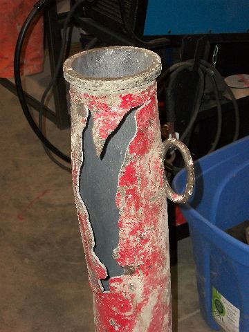

PumPro | 11-28-2011 | comment profile send pm notify |
Must have been a flaw |
PumPro | 11-28-2011 | reply profile send pm notify |
Todd | 11-28-2011 | reply profile send pm notify |
Wow what was that like |
This is way your finger needs to stay on that trigger |
Trey | 11-28-2011 | reply profile send pm notify |
Soda can and duct tape, that'll have that baby good as new!! |
DIGGER | 11-28-2011 | reply profile send pm notify |

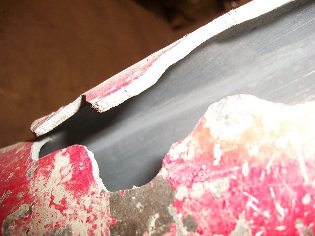

Looks like a Chinese reducer. Bad material and poor heat treatment. We have had several go the same way. |
Pump N00b | 11-28-2011 | reply profile send pm notify |
Had a couple of those too. Cheap stuff from some no-name company. One split clean all the way, looking like a peeled banana skin, yellow as it was. |
concreteluvr | 11-29-2011 | reply profile send pm notify |
Digger is right. Junk product. |
PrefConc | 11-29-2011 | reply profile send pm notify |
Looks like a cast reducer. They wear well, but are unpredictable as to when they will shatter. I stopped using them years ago. Stick with a non cast product. |
rusty22 | 11-29-2011 | reply profile send pm notify |
Remember the fake Putz back end elbow off the hopper. Stick to the name brands and a good supplier.It's not worth hurting someone for a few bucks. |
