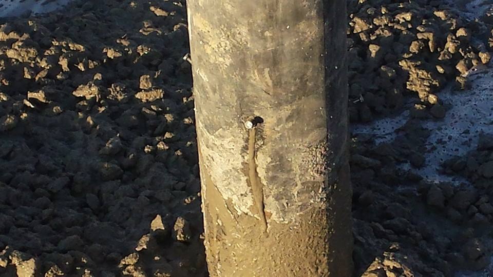

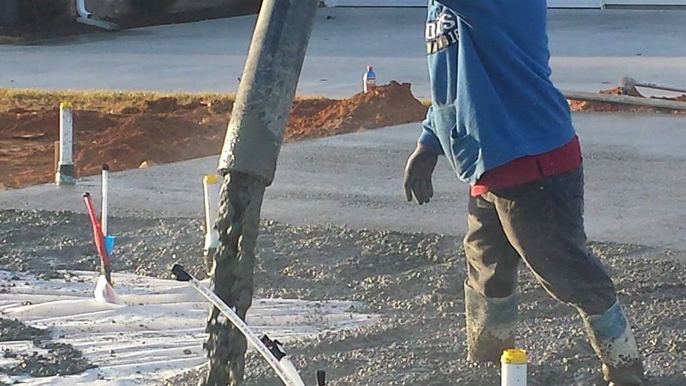

I am told that this will help keep the concrete from splattering durring the poor. Is that true? Z boom 1300 Rpn full hose with tree nails at #4 pumping volume.
ATK1985 12-05-2014
Very dangerous! Rock or fin jam hit nail plugs briefly bends nail violent hosewhip million dollar lawsuit.
TeamStreamline 12-05-2014
I use that trick when topping curbs or pour in place walls. We're talking sloooooooow pump speed. Any other speed, no way.
PUMBO 12-05-2014
The EXCALIBUR concrete brake from Putzmeister worked the same way, and they passed it safe for everyday use, its essentially the same principle, so there shouldn't be a problem. Does it work? Yes. But the problem here is the hoseman is always dealing with a FULL 5" hose which (s)he may not be very pleased about long term.
Dipstick 12-06-2014
Bit like this one. While I was looking for this pin pour picture i stumbled across some other 'interesting' device Yell
PUMBO 12-07-2014
Anybody who used the PIN Pour from Putzmeister should by now have a view of "our Putzmeister friends behind the desks just had way too much time on their hands to produce such a crock of fecal matter (technical terms)."
