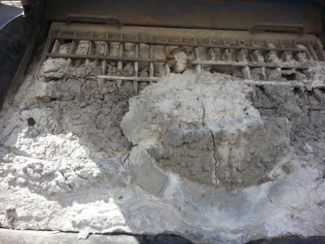

Todd | 09-18-2013 | reply profile send pm notify |
AZ pumper | 09-18-2013 | reply profile send pm notify |
That pump looks thirsty |
N.D.Fuccillo | 09-18-2013 | reply profile send pm notify |
What happened there?!?! |
Todd | 09-19-2013 | reply profile send pm notify |
I was told it was an enviromental problme, weather or something like that. |
dlee7729 | 09-20-2013 | reply profile send pm notify |
Why all the talk? Just wash out when you get into trouble. If contractor orders a pump and has no place for wash out why even start pumping ? |
KBrost | 09-20-2013 | reply profile send pm notify |
Boy, that don't look good. I am glad that was not me taking that picture! |
AZ pumper | 09-20-2013 | reply profile send pm notify |
