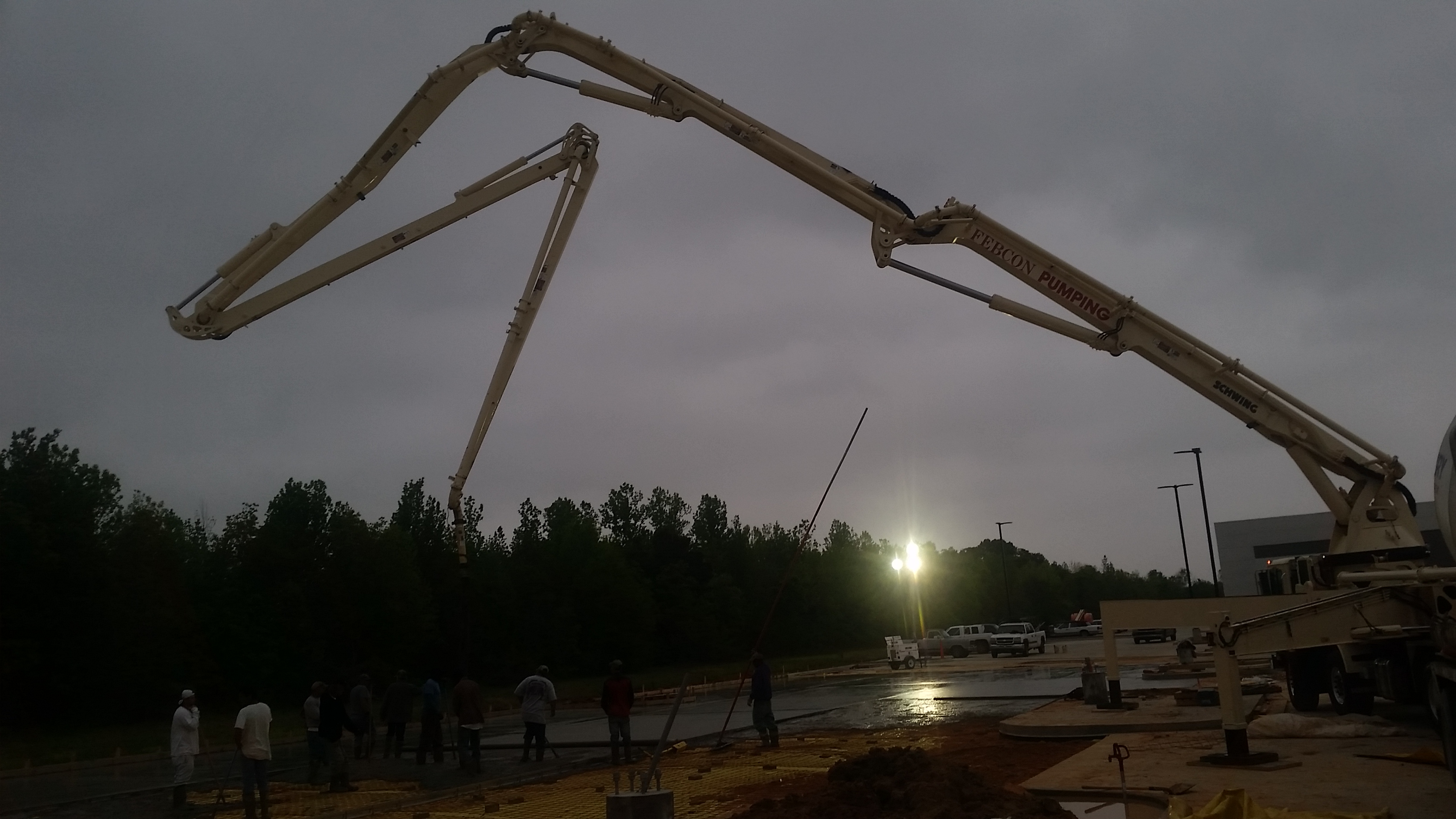

Now that we all have a tool that can determine frequency and distance of lightning strikes,What is the rule of thumb for determining when NOT to pick the boom out of the cradle? |
