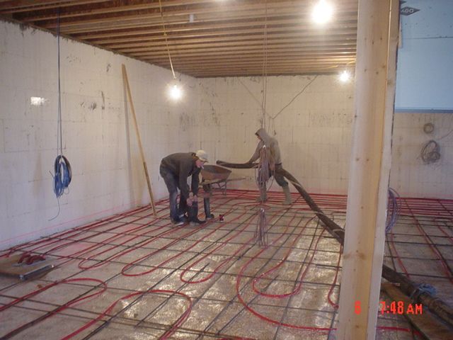

That line pump stuff is definitely an art!! Not to mention hard ass work!!! If i have a lot of rubber hose (and no grout) my very best route is to prime out the boom, then put a 4" sponge in the line. Then push it down a few feet with my cleanout bar. Then fill the pipe with water/cement mix then connect them vertical (as not to lose your mix) then you're golden. Its a lot of hastle and messy but it never fails. Sometimes you get a picky bonehead that wants you to get rid of your primer and you need to catch it in a wheelbarrow like this. In that case, you charge for the wheelbarrow rent (round it off to $80) + $2 per step +$50 disposal(out the door) and $80 for the pain in the ass!!!lol |
