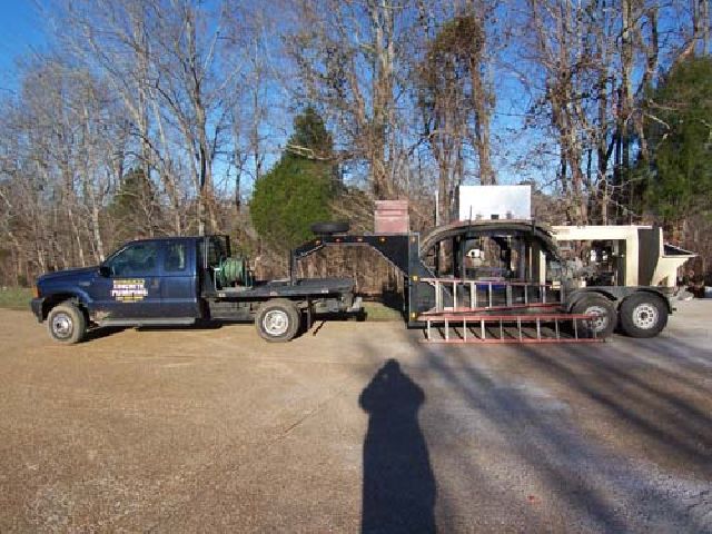

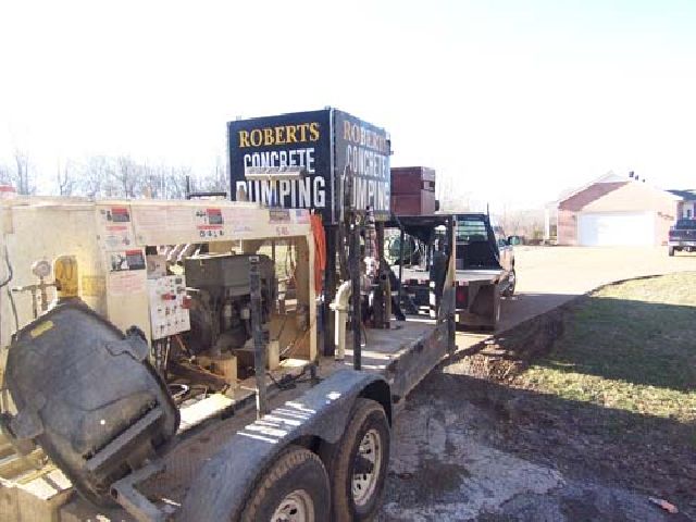

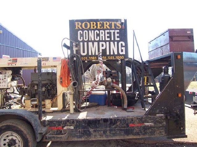

Here is part of my set up. 100 gal 50cc honda pump. about 8 gals a min. @45psi. |

Big Ed you got thr sweetest rig on the site |
