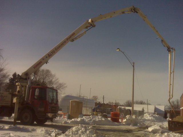

When you line pump and reduce down to a 3" hose off the end of your boom. Whats the best angle of boom to use? I seem to be getting a rock pile plug in the reducer at the end of the boom (PITA). I'm thinking it would be better not to be in a "A" frame position. Because all the mud drops so far and when you stop and wait it dries out. if you wait on a load it might leave you with a rock pile plug. Oh and also when you fix the plug it leaves a huge mess from the vertical pipe.               Any good tips?

Here's a photo for your crtiquing enjoyment:)

If you set the boom to 1-2 up, 3 straight down, and 4 angled as high as it will go it it may reduce the head pressure on the pipe

When I pumped in that configuration, sometimes it would plug, sometimes not, just differences in the mix - sometimes load-to-load.  More often than not, if I could, I'd have 1 and 2 flat, 3 angled down and 4 horizontal, either forwards if the 4th will go above horizontal or backwards depending on the room available and the site layout, or 4 even upwards a bit even, to slow the free-flow of the mud.  I usually liked to give a forward stoke or partial stroke every couple minutes during a break in pumping.
The worst was during the winter, sometimes the tip elbows and reducer would cool too much and the grout would freeze, then when pumping resumed, the icy grout would break free and plug the reducer.

....but,sometimes space is limited,so you don't always have a choice of boom position....

One major problem in this position is if your getting bad loads and plugging there is a lot of mud on the ground when your done fixing. Tomorrow I'm at the same job, will try to angle 4th up? It's is where a Z boom might be worth it..

Your slump and concrete mix design as well as the boom postion have alot to do with it. Kinking the end of the hose does help as long as it is not to cold out that the concrete starts to freeze in the reducer. I only use 3.5 inch hose now because of all the plug problems.

I would also try to get the last section a bit more flat. I always give 2 strokes revers when I have to wait a while. Takes the pressure off the hose. And we always kink the end of the line so concrete won't run out. It avoids seperation. I would not close the airbag when waiting. It gives more chance on seperation. It is handy though to stop your boom from emptying on the pavement. If you don't have a airbag you could try to kink the endhose with the boom but that might dammage the inner structure of the endhose and make it weaker..
Dipstick 02-15-2013
I see you have your reducers hanging up to.. It would already help much if you could lay them flat on the ground. Thats whats causing your problems. Specialy if you don't kink the end of the line straight after you stop..
The wetter the concrete the bigger your problems will be in this situation.. The cream will run through the reducers but the rock will hang there and gather a nice plugg...
