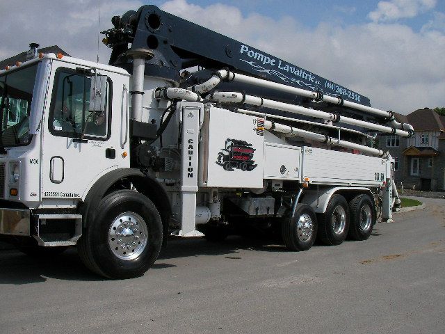

this morning i leave the shop everything was ok .Then 3 minutes down the road the ELECTRONIC Misfunction turn on. and then turn off but anything on the dash that his electric like rpm, mph,volt meter,fuel gauge, turn off too.So i stop the engine start it evrething work.It trun off on my way too the job again .Turn off and on again try to engage the pto evrething work.i tought that it would do it when i will be pumping i done my three job without any problem.when i came back everything was right except for the volt meter that was lower volt then it used to be.It s always be around 13.5volts and today it was around 12,12.5. when i leave the shop to go back home after cleaning my pump again no electricity ,Off/on it works so do you think that i could the alternator or a ground.I changed my four batteries last week cause 3 out of 4 were not good. |
Ti-so | 04-29-2010 | reply profile send pm notify |
1997 schwing 1200/36m on a mack 1997 |
