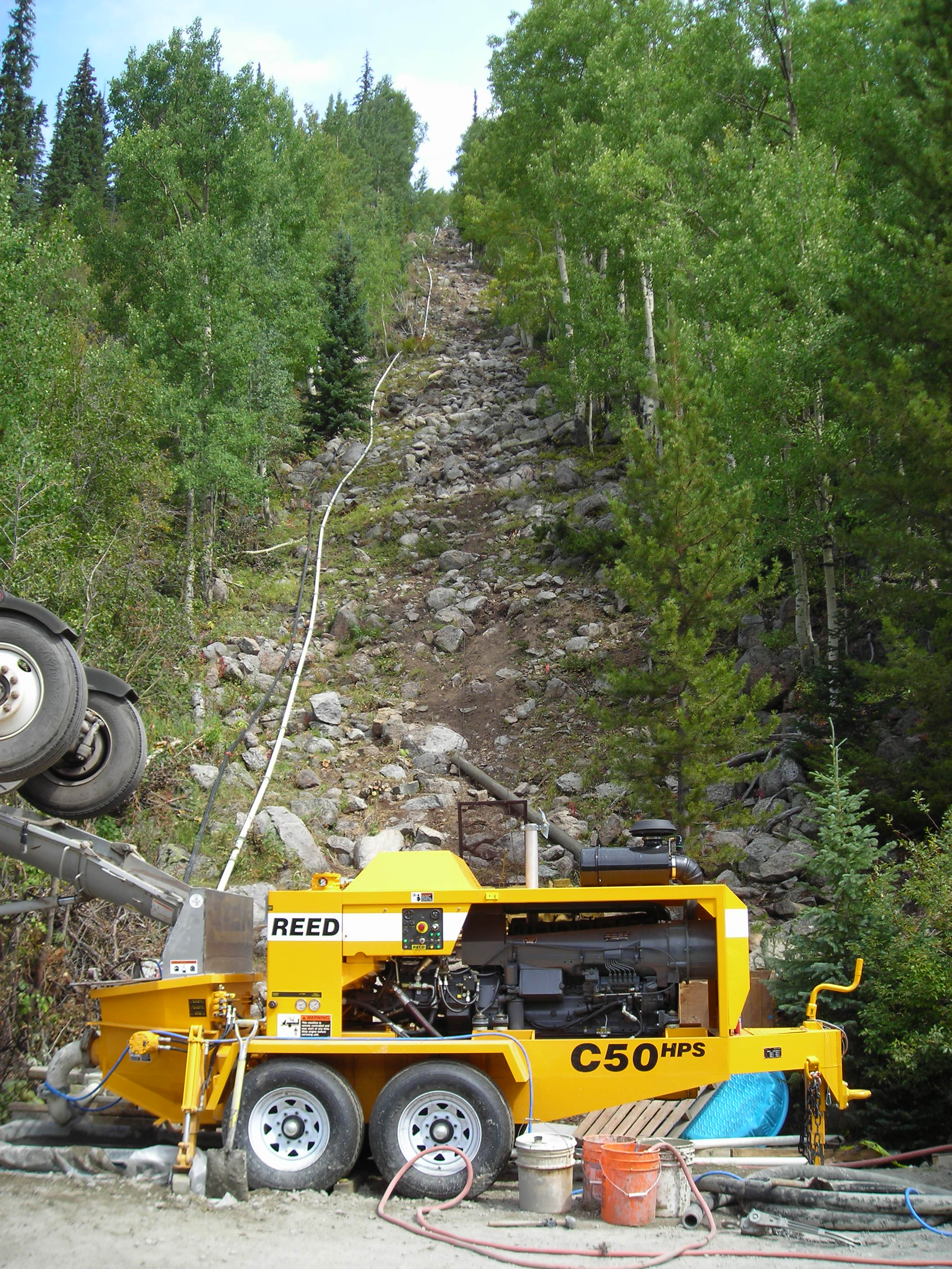

are you in Colombia right now? if so, try our Colombian Dealer Fiorazio Colombia at +57 1 7460035 - they MIGHT have a pump you can rent with a larger motor than that TK or the A30HP - something like a 220 horsepower 2000 psi concrete pressure REED C50SS would be ideal...(a REED B20HP (2100 psi) would also push that far... ((I really don't even know if you put those 2 pumps in a line/daisy chain -(one pump pumping into the hopper of the other, then the 2nd pump taking over)) if you'd be able to get 1850 feet horizontal. Is this a tunnel job? if so, we actually have an electric motor driven C50SS that would easily push that distance... - Mike @ REED Pumps |
