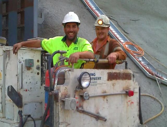

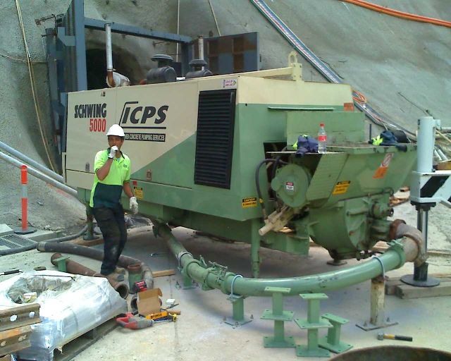

The company my wife worked for recently did a 2500m push with schwing 5000! Hers a pic of the pump and the little train used to cart pipes! |

Very cool |

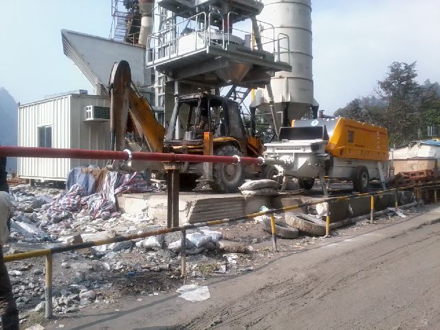

One single Putzmeister BSA2100 (330KW Engine) was used. It was placed directly under the batching plant. Special additive Glenium from BASF was used, concrete used 500kg of cement per 1000ltr. Pipeline was 125mm and yes concrete lost its slump a lot in the process, 200/collapsible at the start of pumping and 80/90 at the end. This was used to do HRT lining for a Hydro Power Tunnel in India with a finished dia of only 3.5m. We had to secure the pipeline in a good way before we could proceed. The photo shows concrete pump, it was only in the erection stage, excavator there was cleaning up something and later removed. We used a transit mixer truck as a buffer between plant and pump and it served well. |

I´m very impressed. Incredible to pump 2000 m pipeline and just use one pump for the hole line. |
16 CELL | 02-26-2011 | reply profile send pm notify |
cool shots! is that a Putz 2109 or 2110 model? |
abdul | 02-27-2011 | reply profile send pm notify |
Its a BSA2110HPD model. I am sorry I mentioned it as 2100 model in my earlier post. Initially we faced some problems due to quality of sand at site but we were able to get over that. i understand its longest distance concrete pumping in India. |
