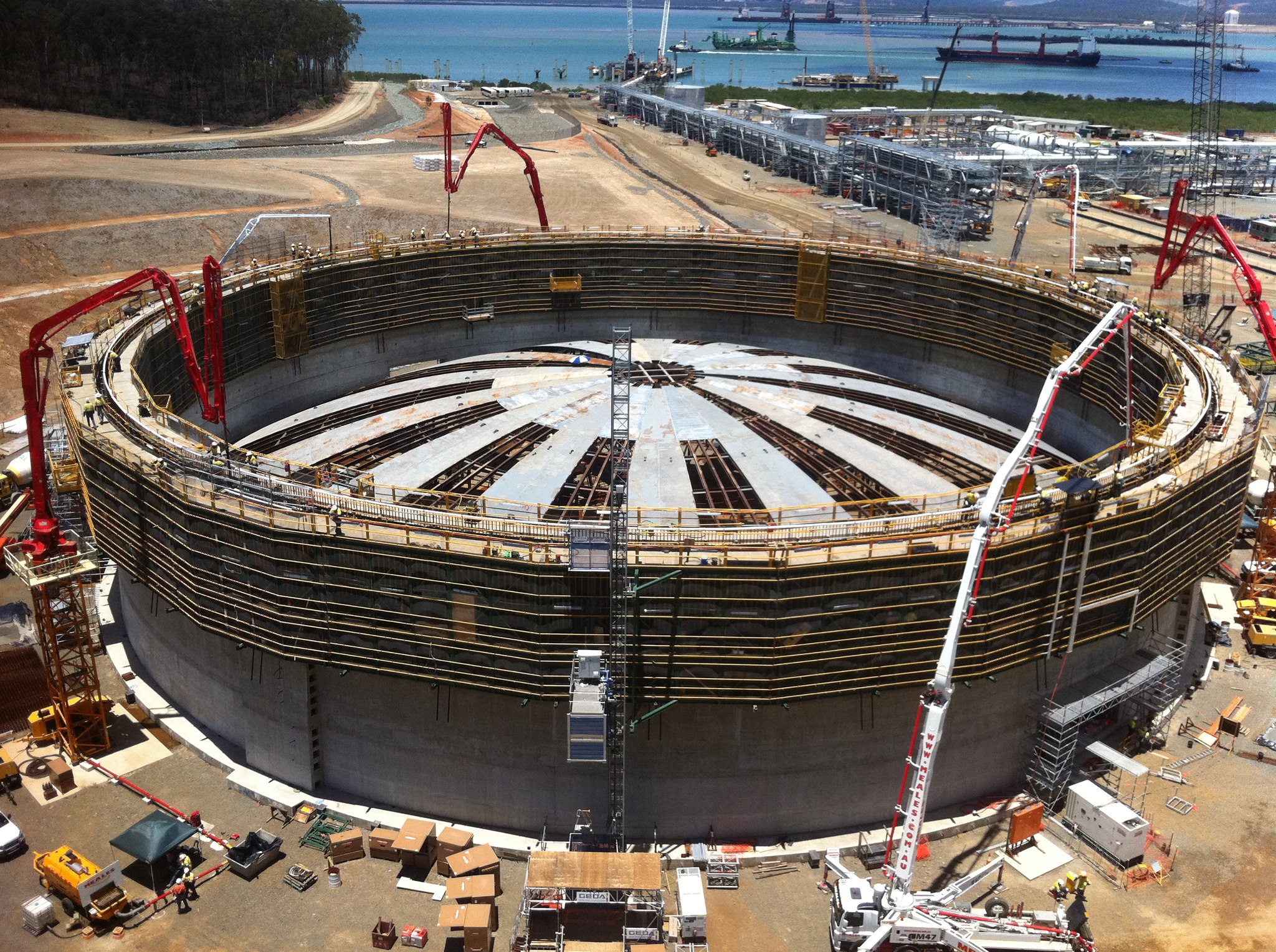

Another lift on the LNG tanks. Photo taken from the tank next to it which is at its full height. This pour is about 650m3. Mobile pumps were used with the tower booms because the towers hadn't yet been jumped up a lift and cant quite reach each other. The tower booms haven't been jumped due to the fact that at the next height up they need to be tied to the tank and on this pour the formwork would be in the way... — at QCLNG - Curtis Island. |
