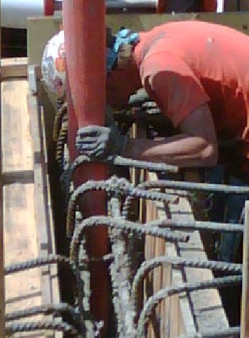

The mud snake collapses but not all the way like the older lay flat hose, ive been able to let the boom drain and suck a bucket to get the snake clean then touch it up on the ground. You see the snake lays flat but not all the way about 1" left open and i don't reverse it full speed just enough suction works. Work what's that anymore seriously cleaning out a 15 to 30lb anything sign me up in this economy ill do anything with pride if it keeps me employed. No real disrespect but common guys if this gives you an edge above your competitor and creates work what's the big deal with a little extra effort. |

Not exactly true Ill take a mud snake over some backwoods hose banded water line any day. You realize this is tested to have high burst pressure. You should really research the burst ratings to the right in the MS bar you and then rate it to your non rated danger hose?
Here is the info on the new hose I was telling you about. I feel that besides the obvious usefulness of this kind of design for tight access walls etc. , the safety advantages are even more significant . The hose can replace the use of pipe and even standard placement hose in many cases . T he working and bursting pressure of the Mudsnake at 1200psi /2500psi substantially exceeds that of 666psi / 2000 on a standard discharge hose and 800psi/2400 on wire braided hose . T he weight factor , when considering common accident s in the form of hose whippings back injuries etc. , should have a positive impact on our industry as a whole as well. The comparisons o f the weight of the 4 ” Mudsnake compared to other commonly used 4 ” hoses are as follows . Mudsnake 1.28lbs/ft . Fabric discharge hose 3.3lbs/foot . Wire braid hose 5.4lbs/ft. Nine gauge pipe 6. 8lbs/ft. The selling price is expected to be competitive ranging somewhere between a fabric and wire braided hose. Thanks in advance for your help in getting this information out through the most dynamic media in our industry ConcretePumping.com
