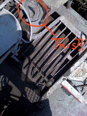

Hey thanks for the tips. Im not sure if what this port hole is called on the "C". Sorry this pic was taken with my cell phone. Right now we are training a guy who is pretty decent, but still no experience. |

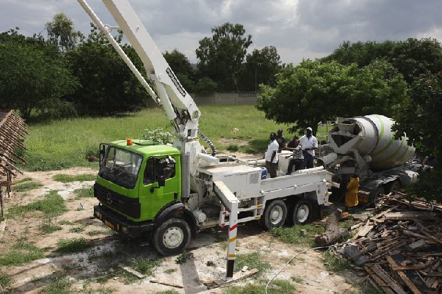

The Meister from the side.
Also, we are starting to get tons of work and requests for a higher boom. We had a company called Jun Jin contact us but I dont know much about them. They have the "S" type pump and apparently some other companies use their systems, and slap a new name on it.
Anyone used one before?
Thanks again. |

The port you have circled on the picture is on what we call the trunk (named after putz elefant!). you use this to either prime with at the start or at the end of the day when you suck back, you turn the cap round to stop the ball being chopped up, then wash the trunk downwards from here, pushing the hose right down ( mind you dont chop the end off!!) with the pump in reverse. when the water comes out clear the trunk should be clean, give the bottom end of the trunk in the hopper a couple of clouts with a hammer and it will free out any build up from inside. you should get a ring sound, if its a dull thud then you have build up. One little thing - remember to give it several strokes in reverse before takin the cap off!!!! on a seperate note- get youself some decent timber pads made up for the outriggers!!!!! |
murf | 10-08-2009 | reply profile send pm notify |
you need new spike welding to the cap to stop the ball when you turn it around |

it my short career of boom pumping, the custumer is alway looking for a longer boom that pumps faster. cheaper to buy more new hose and see how it goes before dashing into a new biger pump, just my opinion. i going to nit pick at you too so dont feel i being an ass hole. buy your self 3 sheets of good ply wood. cut into 2ft x 2ft squares. screw 6 2ft x 2ft squares together and you shall have a proper pad for the outrigger feet. if you find some 4"x4" (or biger) lengths of lumber on site, politly ask a carpenter to borrow his skill saw and cut the lenght to 4ft. ground looks soft where your at. will not make any money to get a new pump if you aint keepin em tire side down :) played with jun-jins for almost 2 years. they pump the mud and were pretty straight forward pump to maintain and repair. its not a putz or schwing, still gets the job gone. Not 100%, that does look to be the prime/grout port. keep em coming DBC1 |

Rig looks pretty good and if it makes you a living then take care of it because as soon as you turn your back it will bit you in the ass. From your picture it looks like a prime port for keeping your prime in front of your conrete which is the first rule for priming. Make sure whatever your using to prime you pump out with wether cementwith water or just plain water all you have to remember is prime is nothing but a lubricant for your pipes,a coating to help slide the mud threw. You can use alot of things to prime, such as (water cement, oil used or new, soap, slurry, slic pac, bednite). All should be mixed with water. Try putting your prime in first and take a couple of strokes to push the prime in front of the concrete, then add the mud. Making sure your slump or wetness of the mud is right. Throttle up, turn your storkes up and pump. If you prime a little fast you'll have less chance of seperating the mud or pluging the pump. Another thing on washing out try to see if your pump can pump water. With no mud in it. If you push water out the end of your boom then you can do what we call WATER WASH. It will clean the boom and hopper in one shot. All thats left is some rocks in the bottom of the hopper. Once you get water out the end of your boom throw your pump in reverse and suck al the water back into you hopper. Then just wash out. It should only take a hopper full of water maybe a little more. You can use the mixers water and probaly with yours you'll have enough. Good luck and I hope it helps. Pumpers unite worldwide....... |

Wow thanks for all the tips. I will get some decent pads tomorrow. You may laugh a bit, but around here there is no such thing as a skil saw. Im from the states and came here to help, but its so primitive.Im still in culture shock.
The business is doing very well and we are adding another pump, so thats why we are looking into Jun Jin.

Glad to hear that you are getting some proper outrigger pads. And like was posted, if you suspect the ground is soft and your pads will sink, then add extra 'dunnage' -timbers to cover more area. With a smaller pump like hat, the weight over the outrigger isn't nearly as high as a larger machine, but you still need to pay attention to it.
