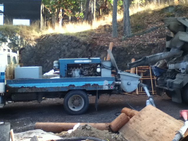

She may not be the prettiest, put the old putz tomcat (older than me by way) still will pump it all day long. |

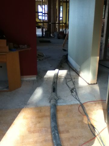

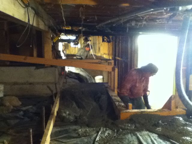

b-alto | 10-18-2011 | reply profile send pm notify |

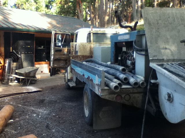

Nice. What size hose are you running, and what concrete mix design. |
Matthew | 10-19-2011 | reply profile send pm notify |
I run 2.5" and 3". Mix design is a 3/8 peagravel 6 sack minimum. Ratios work out to somewhere around 45 or 46% peagravel and the rest sand. |
b-alto | 10-23-2011 | reply profile send pm notify |
Nice outfit. Thanks for sharing. I run 40-60 when i pump pea rock. |
