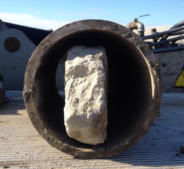

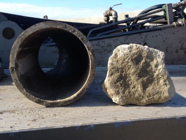

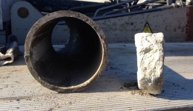

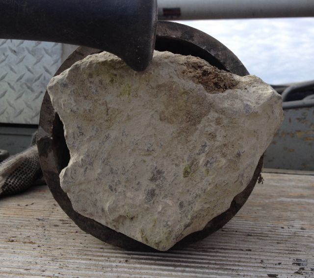

This could have made for a long afternoon, rode all the way through the pipes of our 43m until stopping in the reducer.. |

Still scratching my head wondering how it went through the pipe without getting stuck..should have bought a powerball ticket after that job.. |

parris | 10-27-2013 | reply profile send pm notify |
How'd it get through the grate??? |
Frogburner | 10-27-2013 | reply profile send pm notify |
Parris, I was wondering the same thing. I was running a 5-4 reducer with a 3 1/2 inch hose on the end. I was pumping very slow, just taking it easy when I heard a couple bangs, I wasn't sure what it was so I just kept pumping. About 2 strokes later, I heard the bangs again, now I knew something wasn't right. I slowed the pump just a bit, then the hose stop flowing mud. I knew It was clogged, pulled the reducer and there it was. I run a tight grate when pouring with the 3 1/2, but it jumped through a little spot right by the vibrator, should have bought a powerball ticket that night. |
