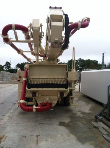

My new used 39!!!!
N.D.Fuccillo 10-06-2012

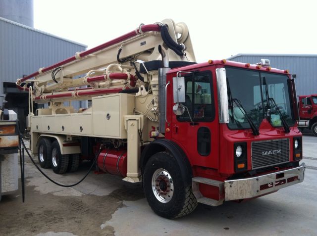

Before

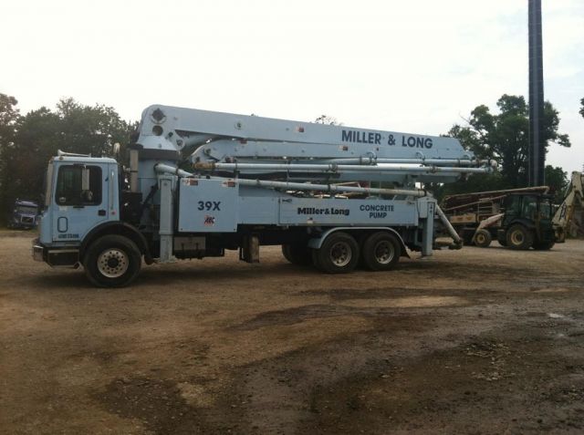

My old 36

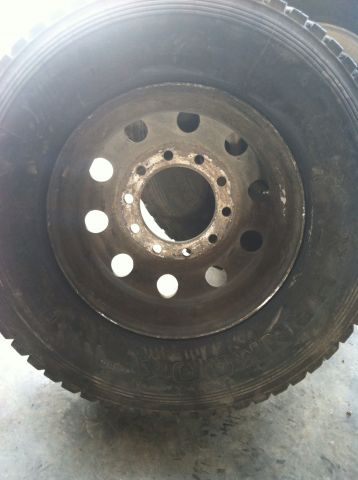

Inside wheel before polishing

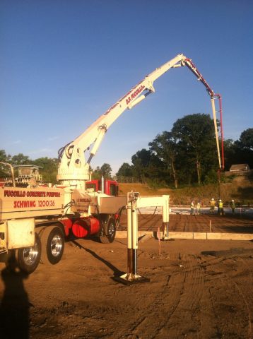

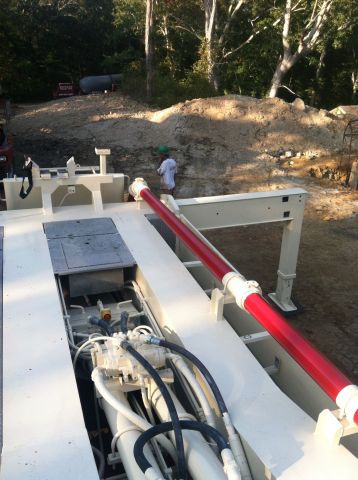

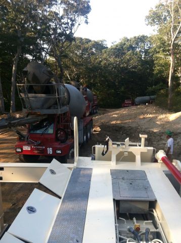

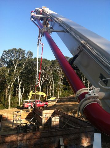

Took 39 on first pump for us yesterday afternoon for a wall pour
200+ yard slab in middle of July. 5000 psi mix

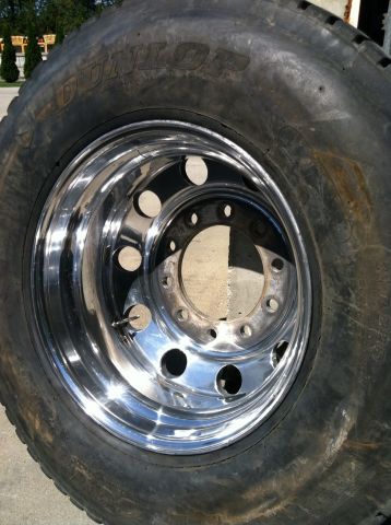

Ok so I gotta know how you polished that wheel out that nice! What's your technique?

sweet i need to know too. how u do it. they shine!

I want to know the secret for polishing too

Before polishing the wheels, all I did wash it with a strong degreaser until it was back to it was clean. To get them to look shinny again after u wash them, you need to get jeweler rouge bars. I used the green bar first which is a medium cut compound and I used it with a yellow buffing cutting pad. Then I used a white bar with a white Cutting pad. I used them on a makita buffer at max rpm. Then after u use the cutting compounds, use a metal polish. I like WAB gray matter formula#1 for the final clean up
The truck is up to date with inspection and correct repairs, and we had it painted by a guy who mainly does mixers and dump trucks. This was his first pump.
