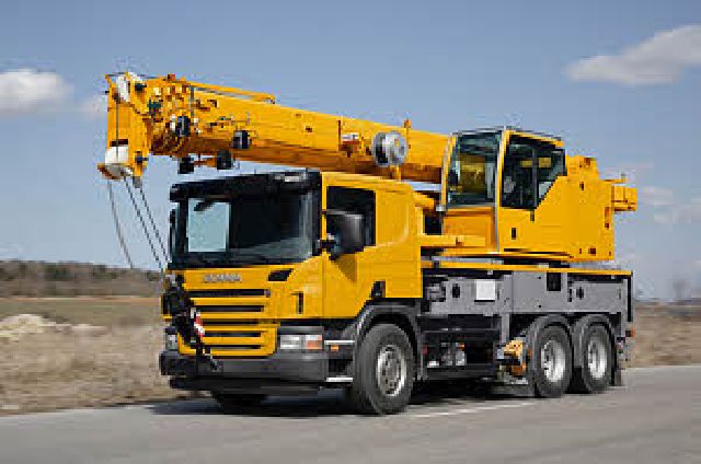

That is why in europe they build small cranes on a truck chassis lol.
SUPERDOFFER | 03-22-2011 | reply profile send pm notify |
B.t.w. http://www.spieringskranen.nl/ buildt there carier whit only http://www.daf.com/EN/Pages/Homepage-DAF-Trucks-NV.aspx components; So they can sell world wide the dealers are already there. |
Dipstick | 03-22-2011 | reply profile send pm notify |
Yes.. And how great these cranes look..... Than i'd almost rather have a MACK... Square sardineboxes.. |
