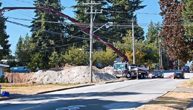

interesting when sometimes you can park up on the side of the road and the powerlines can be within 10ft of the top of the truck.
seedless 11-03-2010
You can't tell them that. But I guess we are all getting older and blinder, pff 20ft eeks. We are still 10ft in Canada. We would have to all go line pump if 20 was the rule,here. Be safe. Hhehe this looks worse than it was, probably an easy 17ft clearance.

Murf raises an interesting point. In Melbourne, the tram network is operated by electrical lines 1.5 KV. Most times we drive under them with 0.5M clearance.

So Ontario is different from BC. Our rule is 10ft BC. Higher voltages of course get up to 20.

if you would of put your main lower and your third higher you could of been father from the lines then you could of rolled tip and 3 your why not get as far asyoucan from lines.  ive done that sam setup 100s of times. b safe.
pumpjockey 11-06-2010
Yeah, really the dirt piles should have been moved to get you further from the danger zone. Pumps are nice on a jobsite, often you don't have to move the dirt, but this is one case that the dirt should have been moved.
seedless 11-16-2010
