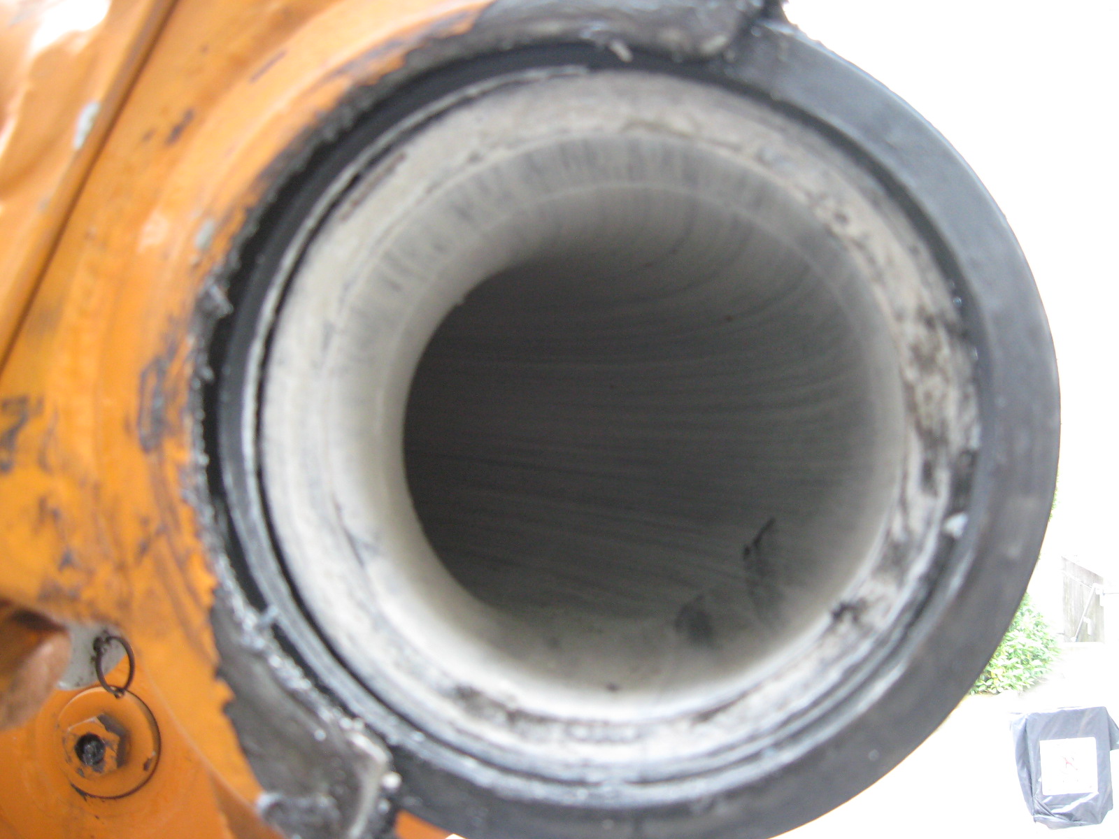

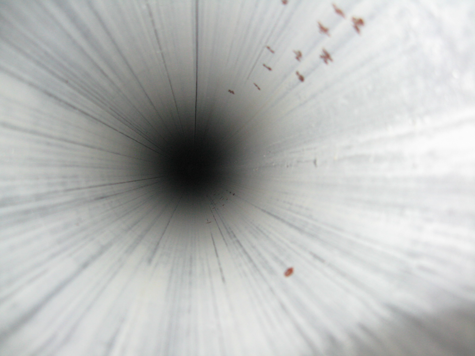

ShortStik | 05-10-2015 | reply profile send pm notify |
i must be doing something different greenguy. suck back folded up everyday and these were my pipes |
