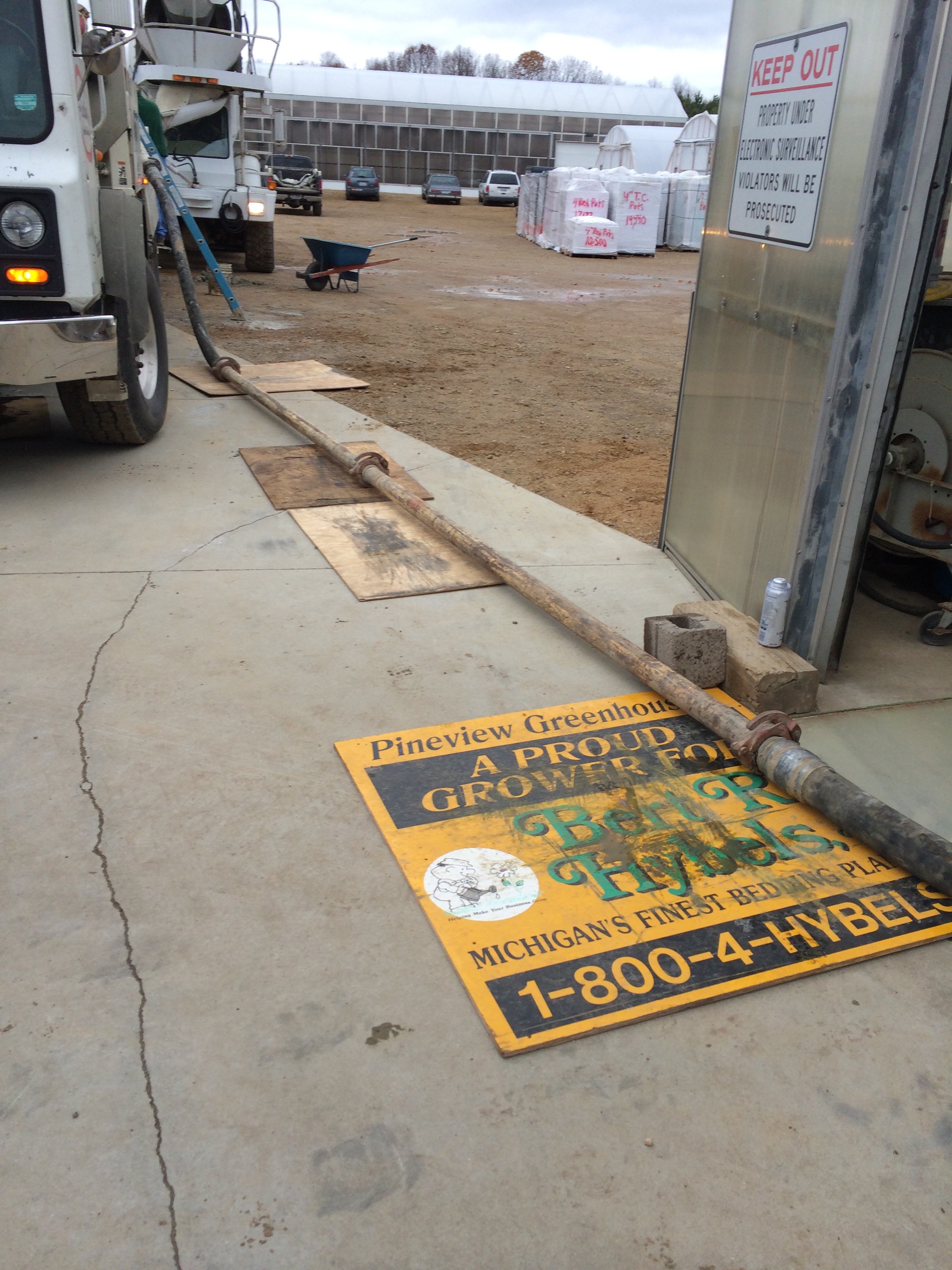

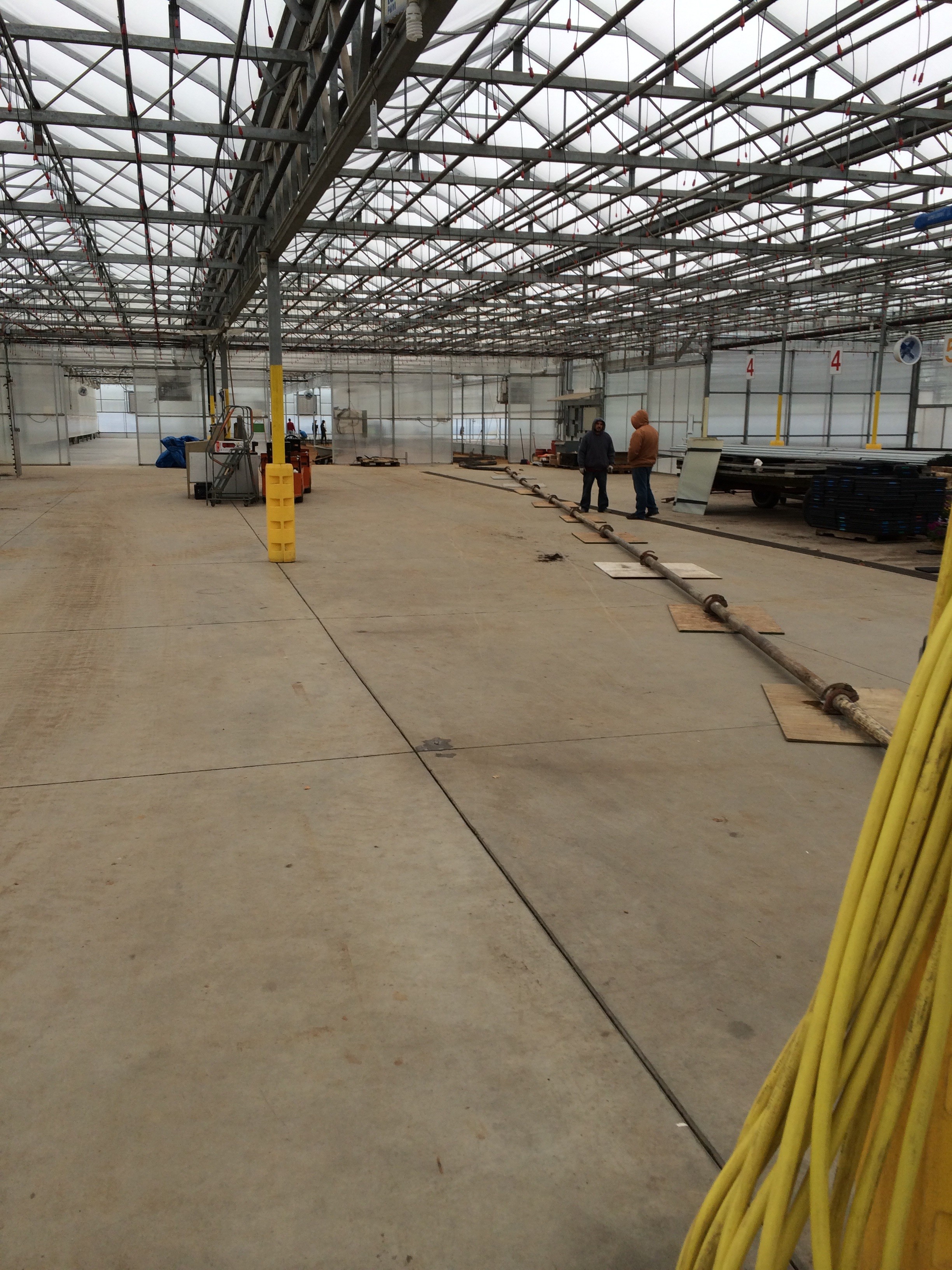

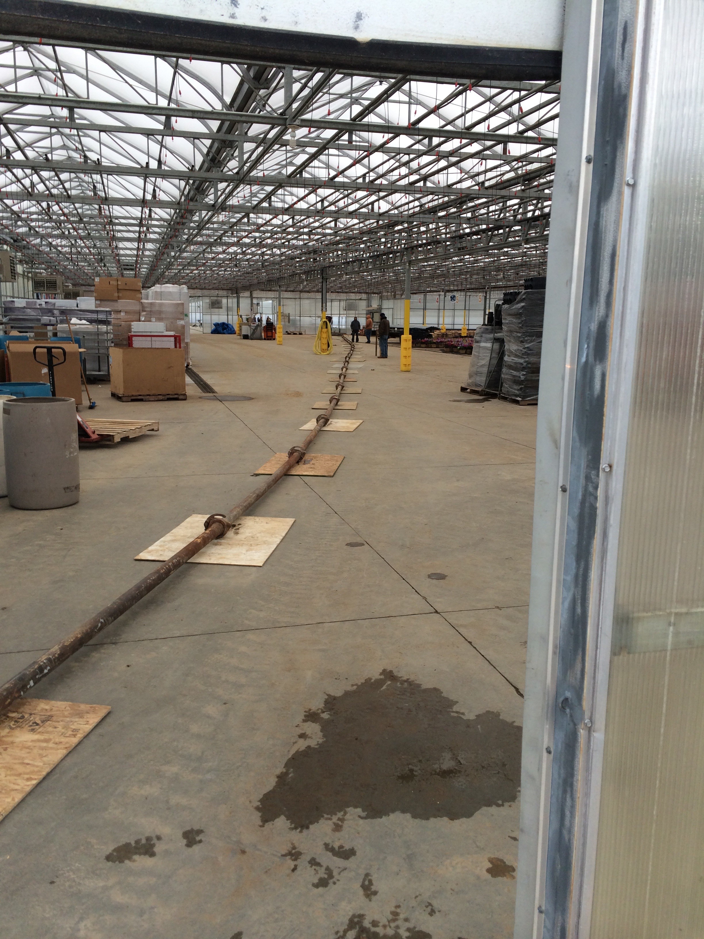

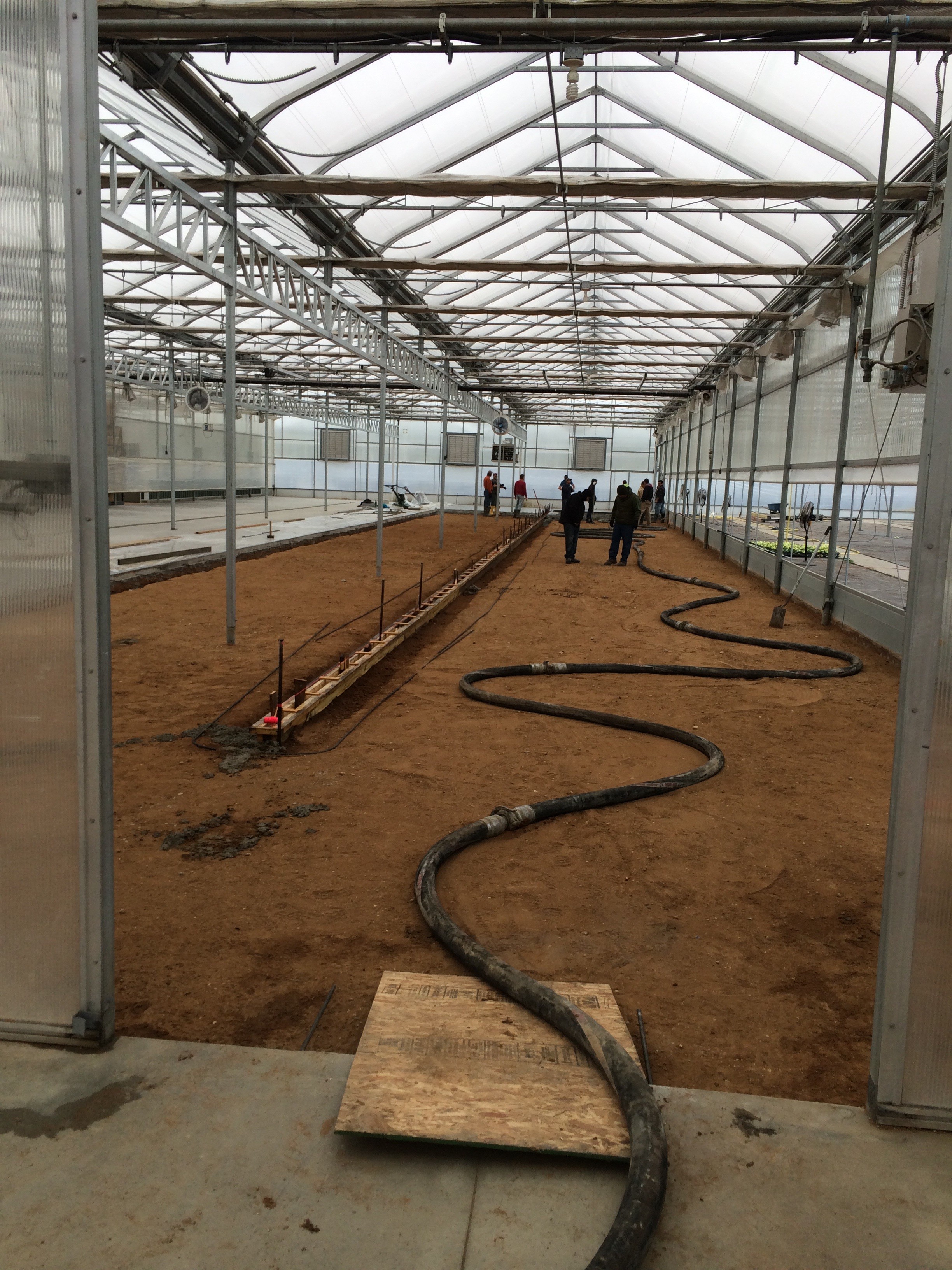

460' of ground line. 4000 psi 3/4" native with 15ppy steel fibre. |

Forgot the middle run |

didn't seem too crazy until i read the steel fiber. Must have a good mud supplyer for a cheap mix like that. houses even use 4600psi (32mpa) out here |
| Pumperman430 | 11-16-2014 | reply profile send pm notify |
looks like some of the pump jobs we get...the ones no one else wants. |
| ShortStik | 11-16-2014 | reply profile send pm notify |
made alot of money doing not so fun and easy line jobs |
