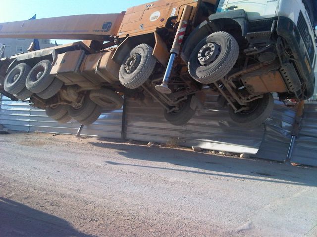

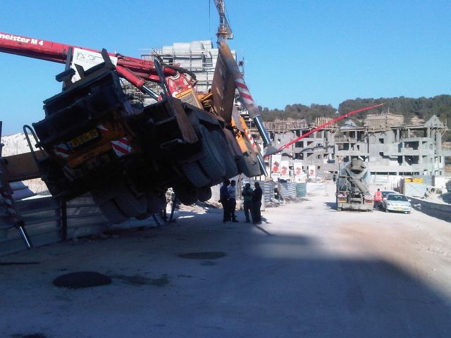

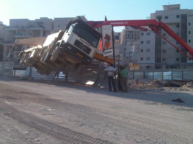

I only can say that i kick this operator a** home. I have pictures of the rescue of my poor 42 Putz if you guys want to see. |

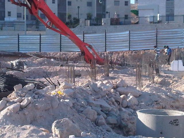

You can see one of my 37 meter Sany in the background |

I'm lucky Putzmeister making strong booms |
| YosiSk | 01-12-2013 | reply profile send pm notify |
Ofcourse I fired him. He did a mistake that you cant live with. |

looks like plenty of space to put the truck more too the left side of that road no need to be so close to that fence and edge of road , but hei, not my call. been in really dreadful situation once when my right outrigger sink in too the ground, fortunately i didnt unfold all the way and i notice that, so no harm :d . |
| The Punisher | 01-13-2013 | reply profile send pm notify |
i could be wrong but i dont see no pads either |
| gaby_steel | 01-14-2013 | reply profile send pm notify |
I know is solid grund, i was speaking on what i experience once. but like i said plenty of space to put the truck more on right side of the road no need to be near of the edge/fence. probabli that explain the title "No words to discribe the stupidity" |
and no pads. laizy |
| putzman1975 | 01-14-2013 | reply profile send pm notify |
its not even a street its a job site no cars jost constuction |
