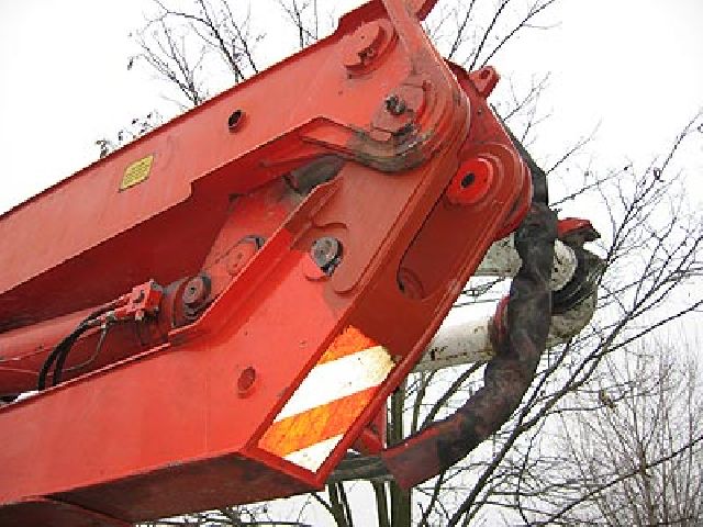

| pudg | 06-17-2009 | reply profile send pm notify | ||||||||||||||
seems as though he may wanna inspect that de hose he got hangin and yes it is a good time for doing some serious inspections so when the work does pick up your ready for it |

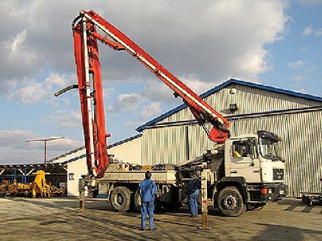

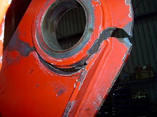

| murf | 06-17-2009 | reply profile send pm notify | ||||||||||||||
this is common with 32 4 section putz on the a-b section |
| jonno | 06-18-2009 | reply profile send pm notify | ||||||||||||||
G’day guys, just wondering what sort of certification you have to have for a concrete boom around the world? In Australia we have to have a visual inspection done every year, the company I am with also has a monthly boom check sheet, which gets fill out by the operator of the pump, but every 6 years the boom has to the have a full strip down and be crack tested, all pins replaced, and rams rebuilt, quite an expensive process, around AU$1000/meter. But you cannot get onto any major job site without a current yearly and 6 yearly certification, and even on small sites if anything bad happened your insurance would be null and void without current certification. |
