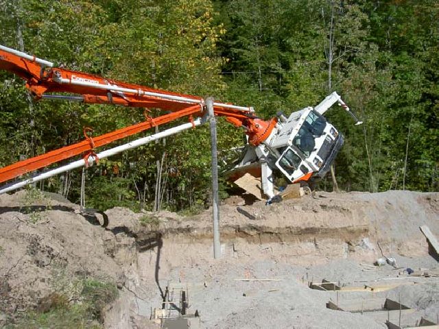

Bad day.
cp1 | 06-04-2009 | reply profile send pm notify |
Particle board usually doesn't work too well for support. |
Trey | 06-04-2009 | reply profile send pm notify |
That'll mess up a wet dream!! That's probally why they tell you to use 4X4's in the ACPA |
WHO?? | 06-04-2009 | reply profile send pm notify |
Judging from that pic and a couple other I have seen...The round foot on the rigger it's self if not sunk into the ground in fact it is twisted under.Leading me to believe he had enough there to support the load.But rather from the way the truck is sitting It looks like the rear outrigger on the Passenger side is not out at all.Looks like that rigger being in and the boom coming around past the front out rigger is what lead to his demise! .....Am I seeing it wrong?? or does any one else feel the same!?!?! |
Step Brother | 06-04-2009 | reply profile send pm notify |
Is there more pics of this? Hope no one was hurt. |
Todd | 06-04-2009 | reply profile send pm notify |
AK1 | 06-04-2009 | reply profile send pm notify |
ok i would say it is a bad day
but that guy needs to fix his gaskets
they are dripping on his roof
( hehehehe ) |
Many | 06-04-2009 | reply profile send pm notify |
Other than unfortunate it kinda makes one wonder is the pumps wood pads were in use.I mean that small rigger foot could concievably punched through.Anyone know what really what happend. |
pumpjockey | 06-04-2009 | reply profile send pm notify |
Do you suppose that it could have shaken itself off the outrigger pad? I'm not certain, but it looks like the job (footings) wasn't a big volume one, if the pads were centered and the stroking wasn't fast (and violent - with boom bounce) I doubt it would have shaken off on a small job like that, unless the dunnage and outrigger pad were unstable and unlevel....who knows for sure? Obviously, something was amiss. |
toper | 06-04-2009 | reply profile send pm notify |
looks likw some really loose soil, i see concords round pad there, but looks like he opted for some 2x10's and plywood, and whats that pipe next to the sunken foot. always extra wood on the front heavy foot |
always |
ShortStik | 06-05-2009 | reply profile send pm notify |
Something is not being shown in the pics. the front passenger foot is sit above ground. i have never seen my outrigger feet slide around. where they've been set is where they stayed. i with WHO??, rear outrigger short rigged. |
but all we can do is guess unless theres testimony from the operator. id guess nobody was hurt if it hasn't been mentioned yet. lucky...for how long... |
Slinger | 06-05-2009 | reply profile send pm notify |
Looking at the trees, the rear riggers were likely short rigged. The thing I noticed is with where the concrete left off that boom was fairly close to the truck with the first 2 sections being almost vertical. I would expect this if it were flat boomed but this is not the case. I agree with Shortstick, without the operator saying what happened all one can do is guess. |
bluefx4flare | 06-05-2009 | reply profile send pm notify |
Looks like he's on sand and short rigged rear outriggers. Thats my guess.
The way the boom is almost A framed, he was moving when he went over.
But then again without the operators confirmation, its anyone's guess. |

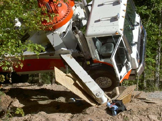

Todd | 06-05-2009 | reply profile send pm notify |
dumpaa | 06-05-2009 | reply profile send pm notify |
Wow that last pic tells alot on what happened! Working side rear outrigger does not look to be out at all!! Two much pressure on front out rigger on working side sent it threw pad and dunage. Kinked the rod and over it went must of felt like time stood still when it started going over!! When times are slow we tend to push the luck to make the cutomer happy. the next time the cainsaw comes out and makes room for that outrigger. hope all is well with everyone on job. |
bisley57 | 06-05-2009 | reply profile send pm notify |
I noticed that the "material" that the pass. front outrigger was set up on was freshly dug from the hole he was pouring in.Notice the natural ground level was 2-3 ft. below the elevation of where outrigger foot is/was.,hence,non-compacted material,not very good for support. |
TooTall | 06-05-2009 | reply profile send pm notify |
Well now he knows how far you cant swing past the front outriggers when its short rigged, even with the boom almost strait up & down! I'll bet that boom came down quick & with a Bang! |
