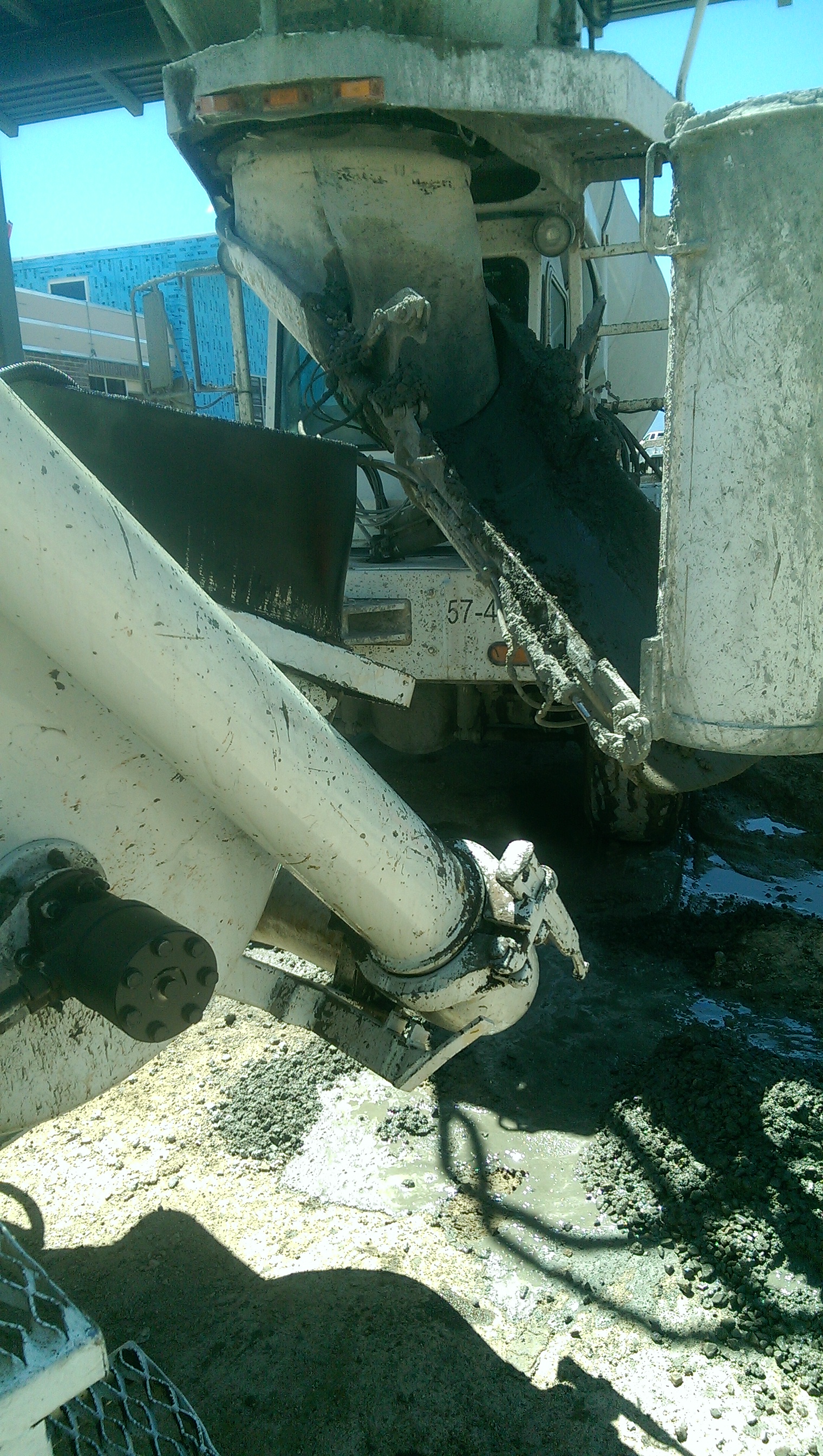

Does anyone have to work with ready mix companies that have these set ups? Sure it is nice for the driver on chute pours but sure can put a pump operator in trouble. Been plugged on the prime from a rookie who couldn't get it up to slump and only filled me 1/4 hopper before spilling over the sides and plugging himself up. And clean out can be a challenge if driver is too lazy to scrape down at the end of the job. They make a little extension to use with chutes in folded position but half are too lazy to use it or the hooks are caked with concrete. |

yes we have them in south louisiana and it all depends on the driver , same as the rear discharge , nothing wrong with the trucks , it's the idiot sitting in the seat that gives you problems. |

HYd. chutes work great for bending the shit out of your hopper slash guards. |

Sorry but.. What kind of a peece of sh*t is that?? |

One of our operators bolted some aircraft grade aluminum c channel to the top of his Alliance hopper and they bend the shit out of their chutes now instead of his hopper |

dipstick, that is dgaf, get er down the road. aint makin money washing. |

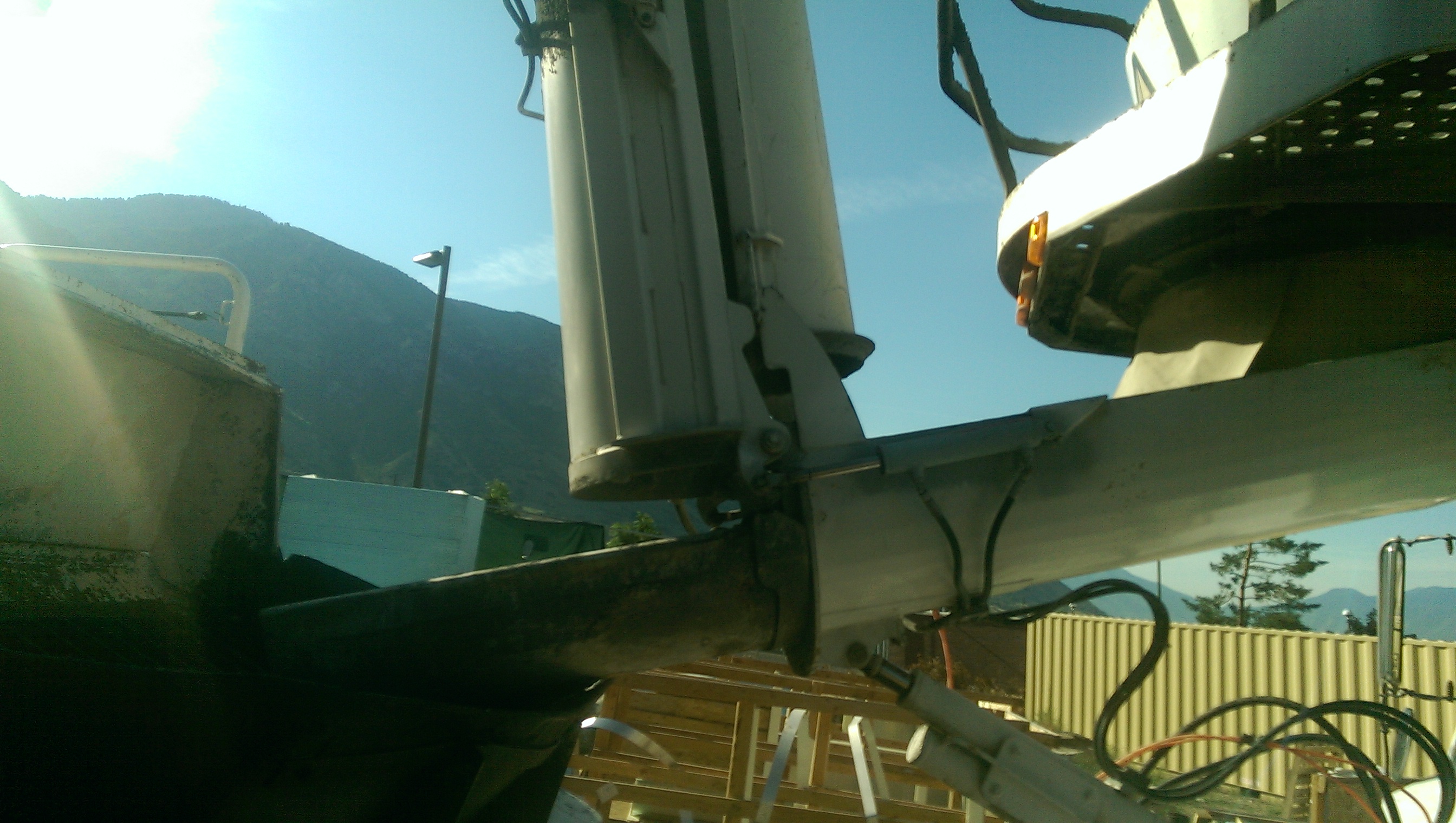

Thats all we have in Tennessee, heres the best way go with the short shute never let them unfold. |

They don't listen Ed. Ready mix drivers know everything. Just got done arguing with a driver about washing his chute in my hopper (10 feet away from pile of broken up concrete. And where he just watched me prime) when I'm running a conforms 3 1/2" hose. Guaranteed plug when they do that. He says but it doesn't plug other pumps (who are most likely running 4" tip hose) I can reason better with my 2 year old than a mixer driver. |
