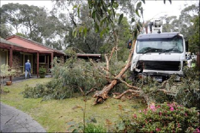

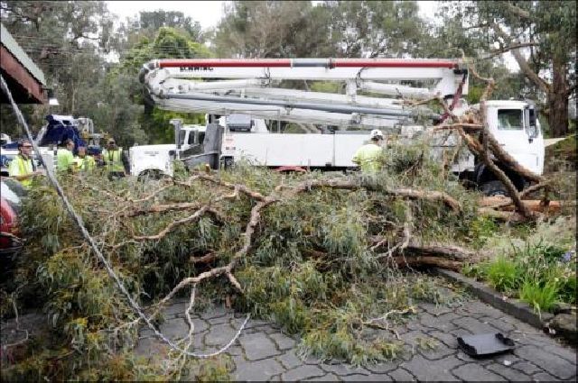

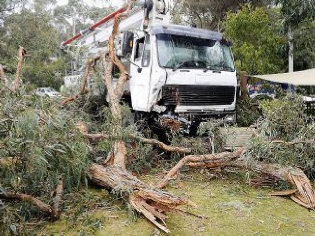

A RUNAWAY truck sideswiped a car and took out the front garden of a Heathmont home this morning.
The concrete pumping truck was unoccupied, but with its engine running, when it rolled 300m down Dickasons Rd about 9:30am, causing chaos in the street.
>>PICTURES: Truck causes chaos
Shocked resident Charles Heathcote said he was at his computer when he heard a “huge roaring sound’’ outside. His wife, Susan, was also at home.
“It was screaming away. My worry was that the driver was still in there. All I could see was a smashed windscreen,’’ Mr Heathcote said.
“The driver came running down the hill and he got into the cab to try to switch it off because smoke was coming out from underneath.’’
He said the driver was shouting, “The handbrake was on! The handbrake was on!’’
The truck knocked over plants on the nature strip and a large gum tree in the Heathcote’s front yard.

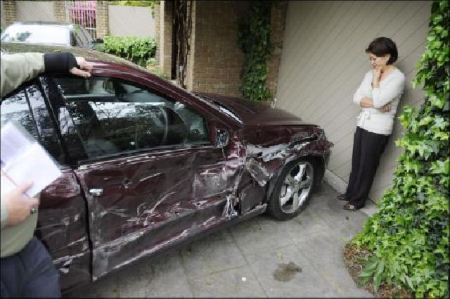

Mr Heathcote said a neighbour, who was driving her car up the road, was hit by the truck but escaped injury.
“We have lost half the garden. Luckily it didn’t get to the house,’’ Mr Heathcote said.
“How do you a value a garden that you have been tending for 30 years? Only yesterday Susan was saying, `I’d hate to lose that azalea just there’.’’
WorkSafe Victoria investigators are on the scene. |
