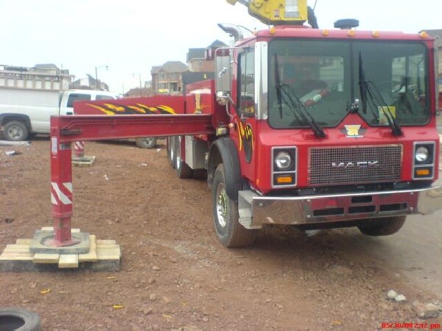

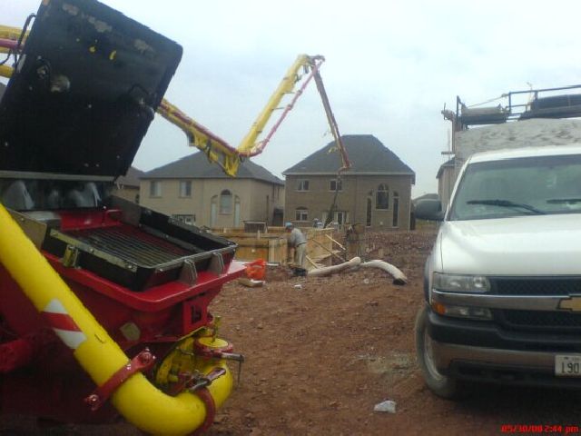

I like to use LVL which is hard to find on job sites because it is so expensive but 6x6 and 8x8`s have always done well for me I was set up 2 years ago on a ramp and it had rained the night before so the clay was slick I put out 7 4x4`s ontop of a old piece of plywood and then 7 more 4x4`s and LVL on top I was set up on there for over 2 hours and then crack she punched through a sewer grate that was covered over with the clay. thie first 7 broke but the other 7 4X4`S held and the LVL So to me when you are unsure more is always better than less This was the job sorry no front pics |
| 38zman | 02-24-2010 | reply profile send pm notify |
found some after I moved from punching the ground |

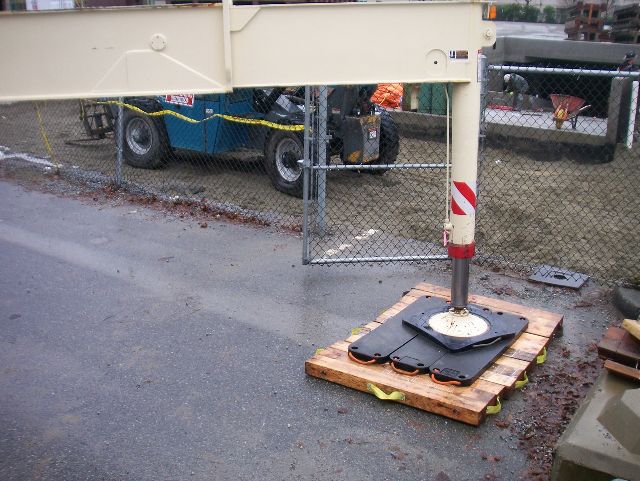

DICA also makes these 48" pads. |
