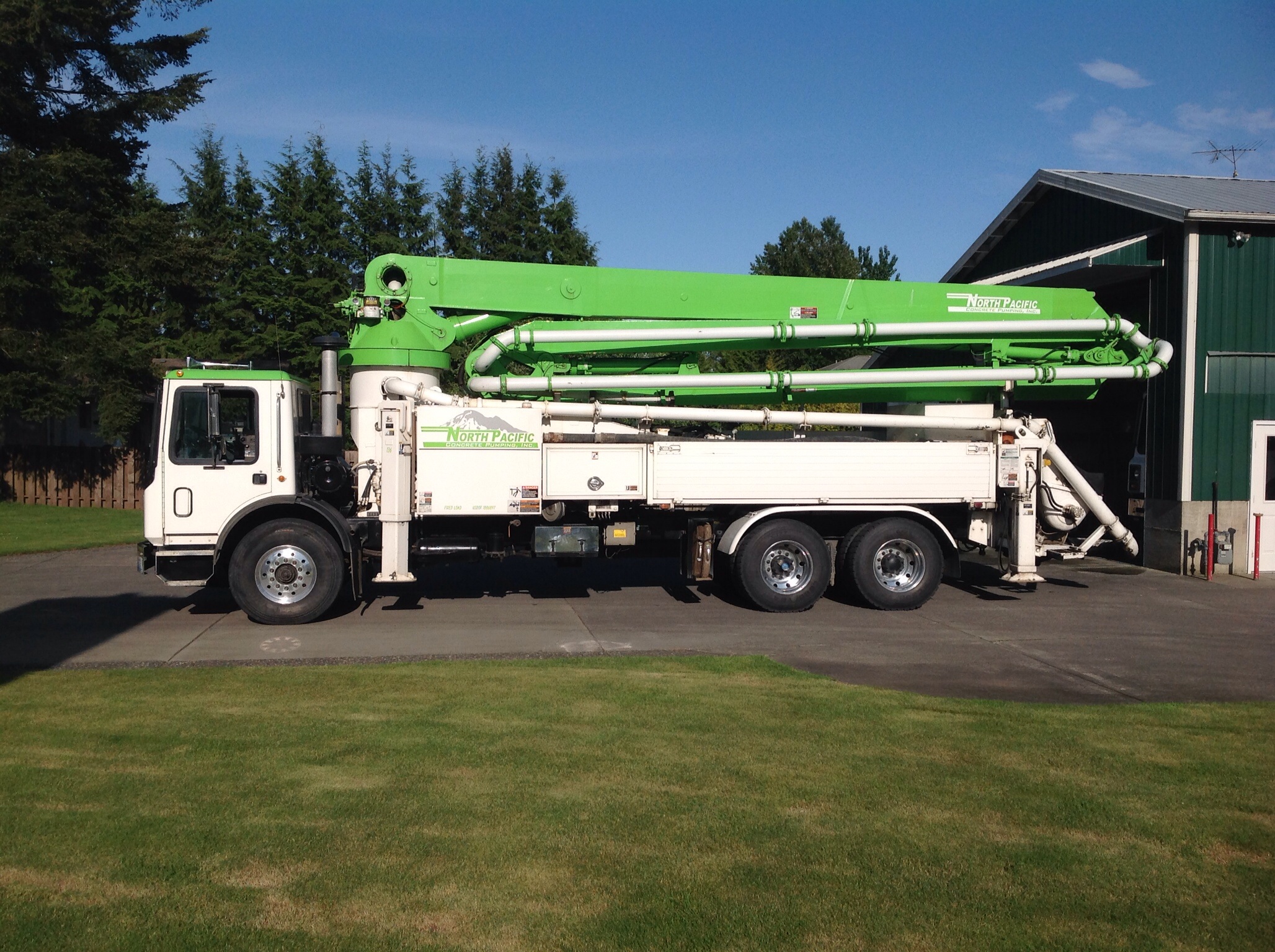

Imron 5.0 is the best but being phased out. I just got done painting my 47 Schwing with PPG Del Fleet Essentials on the pump and PPG Concept on the boom. I painted one pump with concept on the boom 7 years ago on it still has great shine today, but I decided to use delfleet on the pump because it is a true polyurethane , turns to plastic in 72 hours. Remember, any good paint is not cheap! Spend the extra on paint to protect the investment you have on hours on labor For prep |

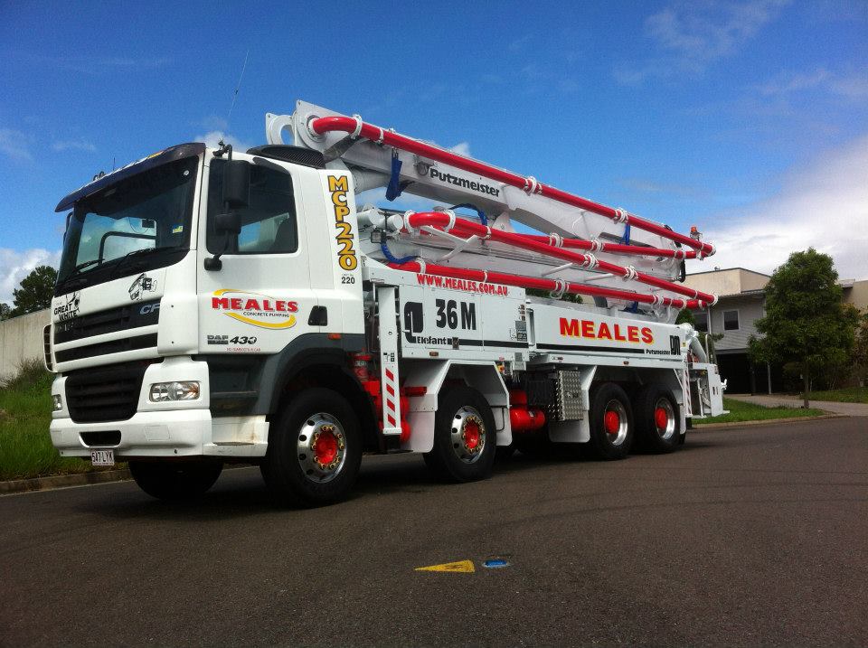

We use epoxy primer, and 2k International top coat. we do a complete truck pump boom sandblast and refurb every 6 years. Pic attached was done last month Acrylics and Enamals and any Single pak paints do not last.. the whites peel, fade and turn yellow |
