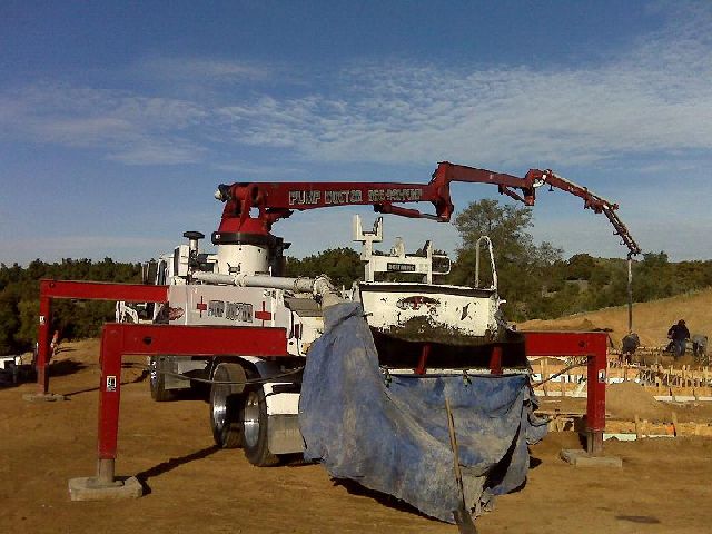

Yeah thats what I am talkin about when I say "lean it away from the work side" even when I am pumping ..say off of the Pasenger side and the front I do my best to lean the truck away from the pour just a little bit...Then like I said I like to go back and double check/tighten up the outriggers...Like in this photo..I had set the truck up,Kind of leaning back on the Drivers side rear out rigger...I was just curious if I am over thinking it or if any one else has a preferred method of setting up

I have tried the "Level" thing but what I have noticed is,When I get set up "Boom in the cradle" and have her all leveled up.when I get the boom stretched out the pump leans the direction of the boom.You have to remember that the out riggers will have some "Flex" to them and when you get them loaded they have more weight on them,Also when I have her dead nuts level and stretch out over one side the "Off Side" riggers are floating a little bit,And by leaning the truck a little bit (in my mind)it sort of "Pre loads" the off side and the whole truck seems more solidly set....Like I said I might be over thinking stuff.. |
