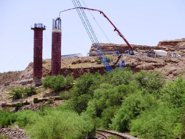

trying photo upload

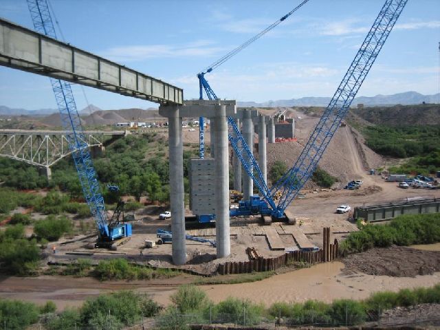

500 ton crane

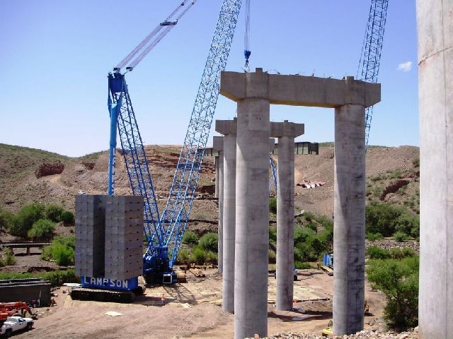

back side of crane

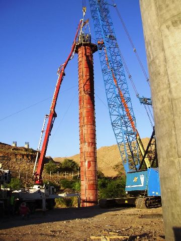

my 39 meter

Holy crap that is a HUGE crawler!!!!
typesdubs 07-30-2009
More likely a Lampson 1500 ton crane. 500 ton are some bigger crawlers you see on stadiums and power plants, these cranes make those look tiny

SO?? It's not a crane on tracks?? if it is does that not make it a CRAWLER??

Counter Wheights From Hell!!!
peter pumper 07-30-2009
columos were 98 feet off floor caps were just over 100 .  the spans were 285 feet long and weighed like 300,000.  the counter weights were boxes full of gravel.

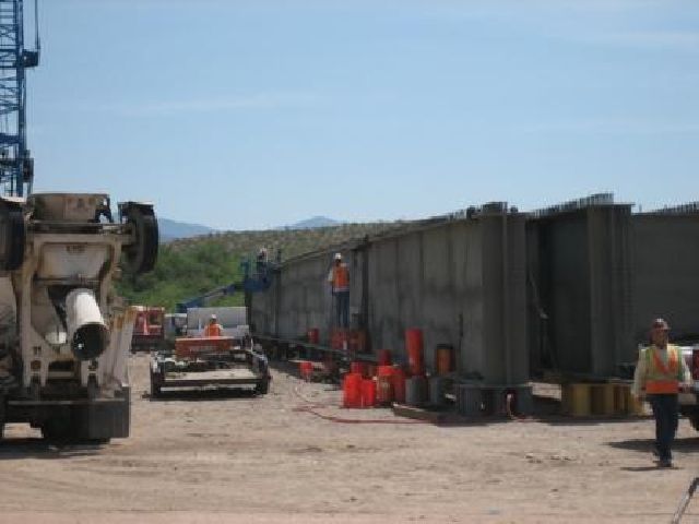

spans are tall

Yes it is a crawler (two sets) and fully mobile under load. Cool job!

how did you get the trimmie in & out? we know they didn't drop mudd 98ft.  nice pics.
peter pumper 07-31-2009
the job was in threeway Arizona a new bridge arcross the gila river.  Arizona highway department job. they had guys down inside the rebar vibrating the concrete.  they had a trim pipe in 10 foot sections they took out. sorry about not posting more info was testing photos i have more jobs.

yes job was in the middle of nowwhere more than one hour from batch plant.  39 meter pump. had the large span because of the railroad that runs along river and enviromental concerns. could not get in water.
