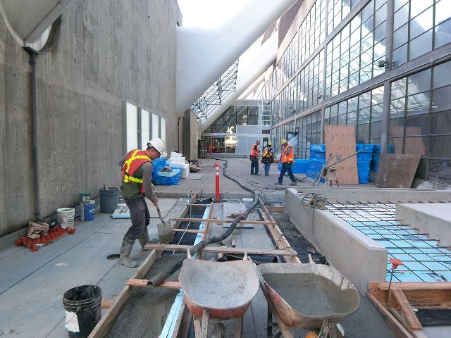

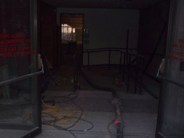

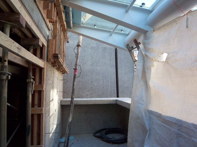

16 CELL | 10-07-2009 | comment profile send pm notify |

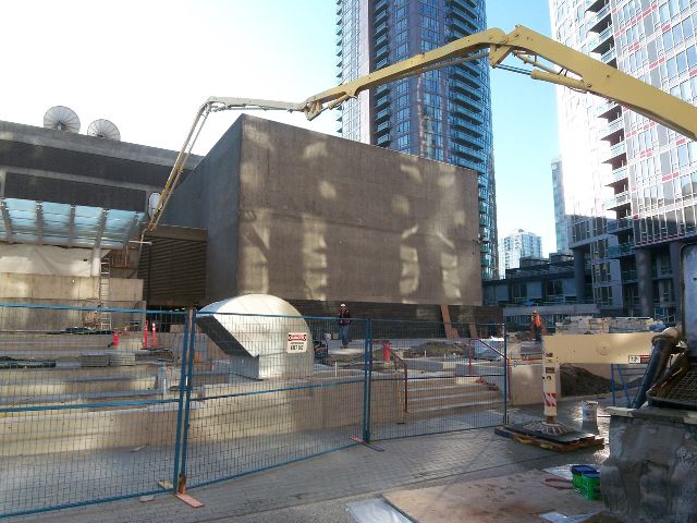

couple hundred feet off of the boom, child's play compared to some of the setups I have seen Mr. wibau post on here... but still enough hose dragging for me to get a good sweat going... |

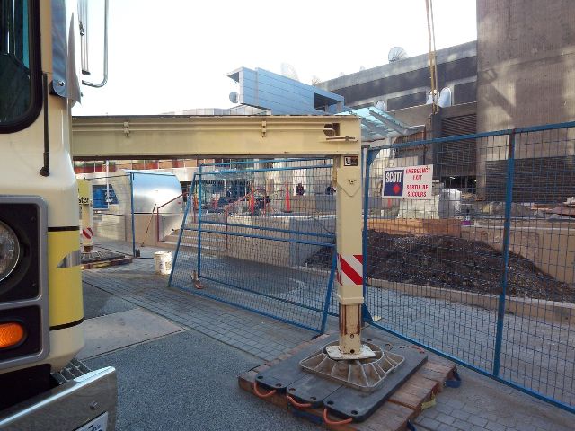

i think its from all the sun he gets out there makes em a little nuts. thats a neat looking building there. looks like you ve been get some dick and fart jobs as well, work is work though. the best part is you pulled a sweat draging hose. Kuddos to yah 16Cell. WCB can only compliment you with the dunnage under your pads. Keep doing it right and WCB will leave us alone keeping em tire side down |

haha sweet pxt mate glad to here i am setting the standard for long pushes. this is my i have keep my pump flat out and cant forget all the blockfill i get. love your pads mate she is going no where. as everyone asks me how i washed up and slurryed up, as i get the chance now how did you go. |

Cool. And clean pump, except for the mess the mixer driver gives you. :D :D |

the hell with the hoses you had to sweat puttin out all that dunnage,lol,great job. |
getRdone | 10-08-2009 | reply profile send pm notify |
Weres they laborers at with that kind of donnage. Im sweating just looking at it. |
16 CELL | 10-08-2009 | reply profile send pm notify |
For that particular pour I water primed the boom and cycled into the hopper, then dumped bucket of mortar mix (fattened up with a little extra straight cement powder) into the the system just before plugging it into the boom. Most jobs with 100ft. or less hose, I just dump a bucket of grout into my slurry port and prime through the boom and system all in one go (or at least try to). My favorite primer is a bucket of mortar mix with a pinch of bentonite, as long as there is a suitable place to dispose and it so it does not find it's way into the pour...
Wibau... does your Jun Jin run single (16 cell), or dual (18 cell) Hydraulic pumps , it seems to push really strong through all that line... |

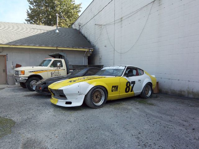

shortstick... we actually have road racing out at Mission... that's right both left and right hand turns ... I had not run for a couple years because I was too busy pumping, didn't run this years because I wasn't doing enough pumping to be able to afford racing... screwed either way I suppose...

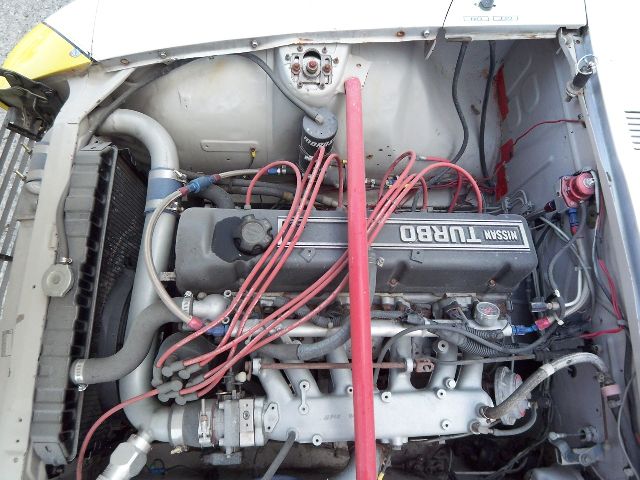

Wibau, great looking ride, but I would have a word with whoever built it.. (they put the pedals and steering on the wrong side of the car...) LOL |

nice ride mr cell, but i dont think my car is the problem. i think you need to talk to the builder of yours and ask them why they left there missis hair dryer on the side of the motor. haha. |
