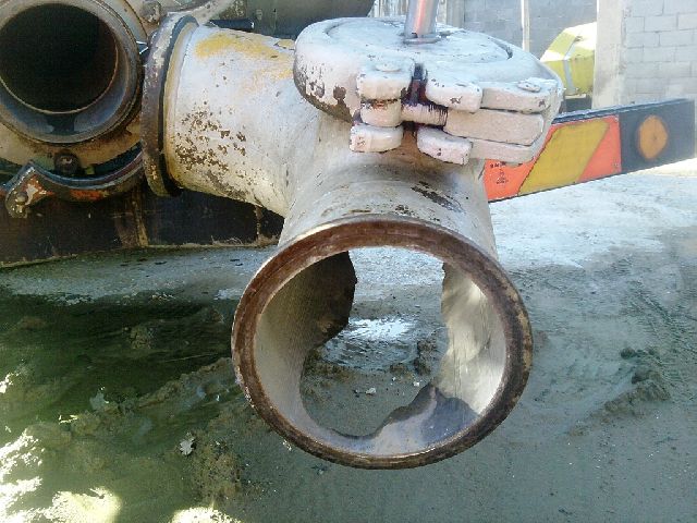

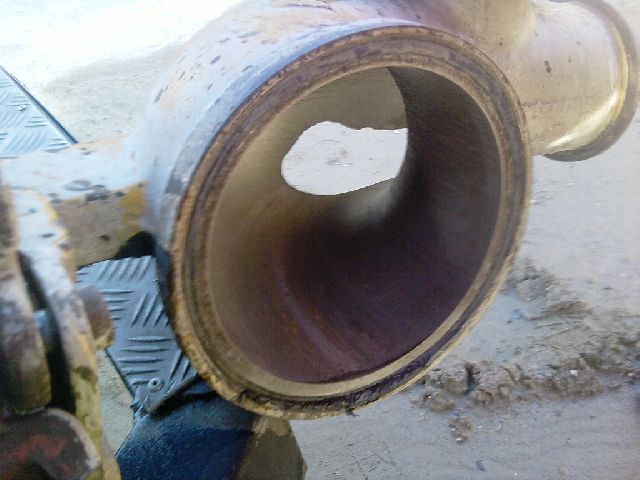

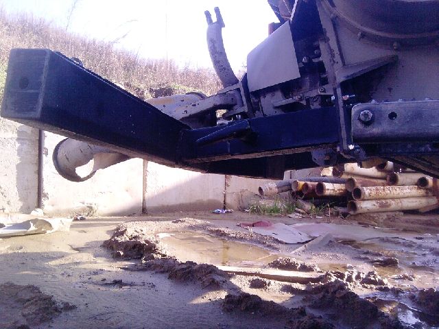

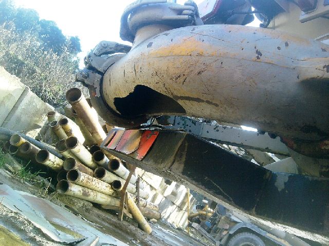

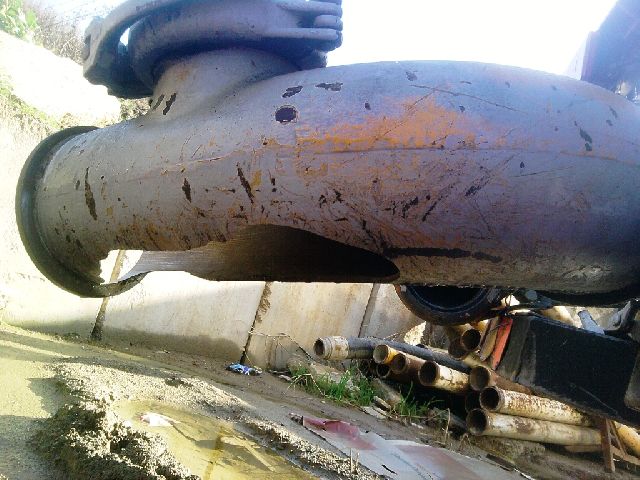

cifa k 35 | 02-05-2011 | comment profile send pm notify |
after how many hours do you think should be changed? |

nzpump | 02-05-2011 | reply profile send pm notify |
Looks like it is worn way too thin. How many hours did you get out of this transit elbow ? |
Many | 02-05-2011 | reply profile send pm notify |
Wow,way to scary.That's a perfect example of why bbcp's blast net works.The rock and fluids could have went right into the mixer drivers legs. |
ALMIMA | 02-05-2011 | reply profile send pm notify |
Not so nice if that happends when you pump at the 8:th level in a building, and you placed the pump on a street crowded with traffic. That will be: "just another day at the work"..... |

Do you not hard face the inside of your swing 90 and your 1st 90 to your reducer? |
cifa k 35 | 02-06-2011 | reply profile send pm notify |
success and a concrete pumping very hard consistency ...! this curve has pumped about 3100 hours ... I had never happened before, and guys are still at work ... and anything can still happen ....
murf | 02-06-2011 | reply profile send pm notify |
For those using a thickness tester a point to note-the obvious place here to test would be the outside radius of the bend, however with the introduction of a grout/washout T point, the pipe will wear most opposite this T point. This is because the forces are greater against the opposite wall of the T with the T full of concrete. |
