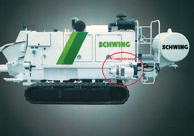

The built in pressure washer gets his hydr. power at the same port as the water pump, but there is an extra valve in between which is regulated electricaly whether to wash or to pump. The auxilary thing you might be talking about is normaly the compressor port.

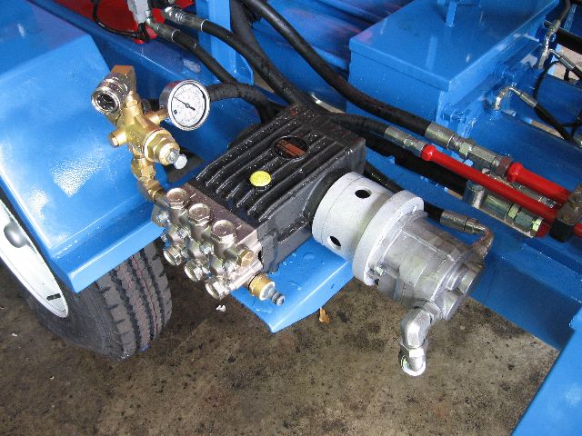

We fit hydraulic water blasters to 90% of Transcrete pumps. You need 2,500 psi and 20 cc hydraulic motor to develop 20 cc flow of water at 2,000 psi. A pressure loss can be found depending on the concrete pump circuit. |

Thats a nice little unit Digger. Casse i think your right about the compressor. I wonder what the compressor option would be for? and if i could tap into it for a feed. They sell water pressure pumps on Ebay most have 7/8" shaft drive. Just think how clean my pump would be. Not all Grey. |

Well, the compressor option is, surprise, for a hydr. powered compressor :D so you dont have to use the trucks seperated air, which is only ~8bar and not for long time use. I dont know the exact differences between both hydr. ports, i ve just put them together ;-) Doofer, still, both things are connected to the same hydr. Port. Just the switch is done different? Still something i ve never built that way, maybe after market attached? Its pretty hard to discribe something technically in english for me, german would be way easier :Ddd |
