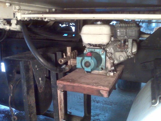

Got it hooked up, just now my presssure adjustment on the brass outlet doesn't work so when you let off the handle the motor quits. It would be great to use the soap injection and suck up some cleaner, I never have tried this. Nothing dirtyer than an udercarrage on a pump truck. Good idea about cutting off the pipe handle. |

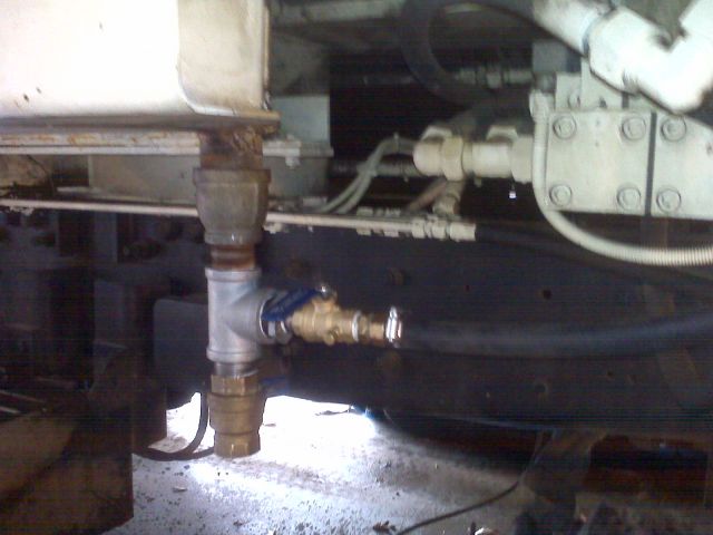

Feed off the water tank. |

How do you start it? Or put fuel in it? It looks really tight under there |
| b-alto | 03-20-2012 | reply profile send pm notify |
Yep :) Starting it you have to wrap your hand around the back, I'm working on maybe a pully system. Gas i'll have to make a funnel with a hose (i did how ever fill it before i intalled it). The shelf is metal i just used plywood for the top, and also i bolted it to the frames because i didn't want to weld. All in all it was pretty easy. |
| Goose2448 | 03-20-2012 | reply profile send pm notify |
Couldnt you just drop it a foot or so, cant really tell the height in the picture, and turn it around. You would just need more hose. And dont forget a nice recoil mech for your highpressure line and about 50' of it so you can get to everything. |
| pumpjockey | 03-20-2012 | reply profile send pm notify |
You're going to need some gussets on there too. Create a triangle. Not too sure on how that wood is going to hold up - the shelf or the spacer on the verticals. |
i could have gone a couple inches lower is all to the bottom of the frame. I chose to use some pre drilled frame holes, plus if its lower it is the dirtyer it'll get from road mess. Speedy at first i was going to put a 45 degree brace in, but the metal frame bolted tightly against the back and one side its pretty sturdy if need be i could but its just more crap in the way. I just bolted the wood in the channel for backup on the sandwich bolting of the side. Filled the hole. |
