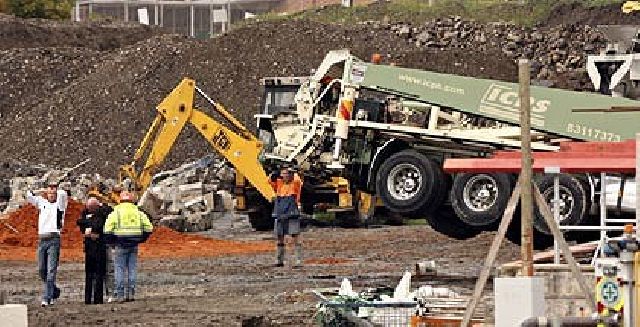

| The Cat | 02-06-2010 | comment profile send pm notify |
http://www.theage.com.au/national/man-dies-crushed-by-pump-20091015-gz71.html |
