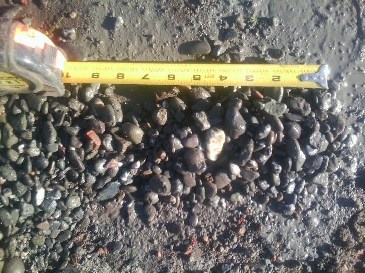

| Pumpatude | 01-19-2015 | reply profile send pm notify |
here is what I walked out of my hose today after water washing my lines |
| biged | 01-19-2015 | reply profile send pm notify |
That looks good thats a blended rock, I sold my company last Feb when ever I would be working around Kentucky lake thats what the plants used river rock rounded edge's it pumped good 4 in slump no problem, never got down there very much. Thats a good area Ronnert Park, I used to work in the sing business back in the 70's there is a lake that was built and opened up in the 80's a BassClub that I was in used to fish it, hang in there hows business
