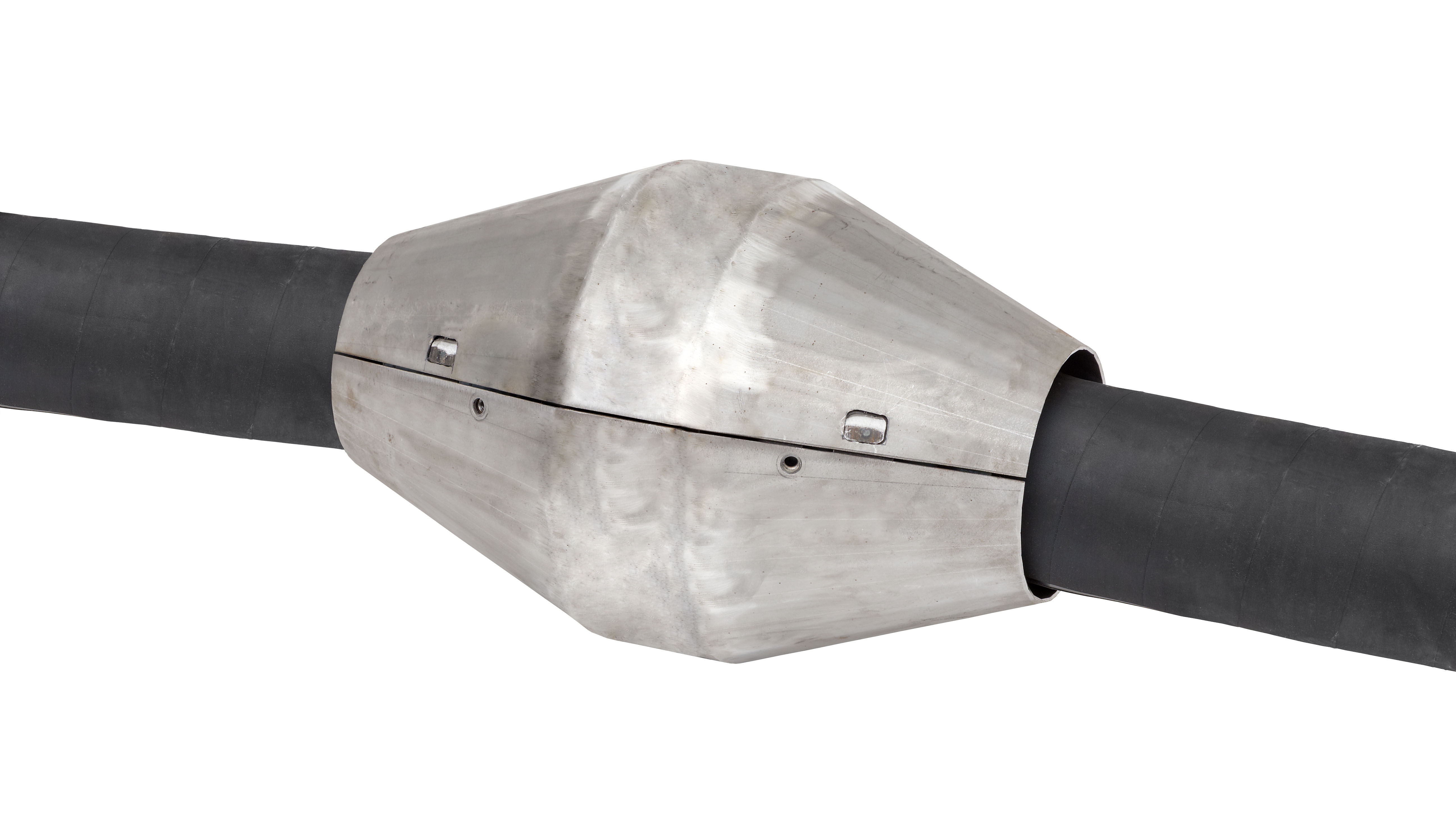

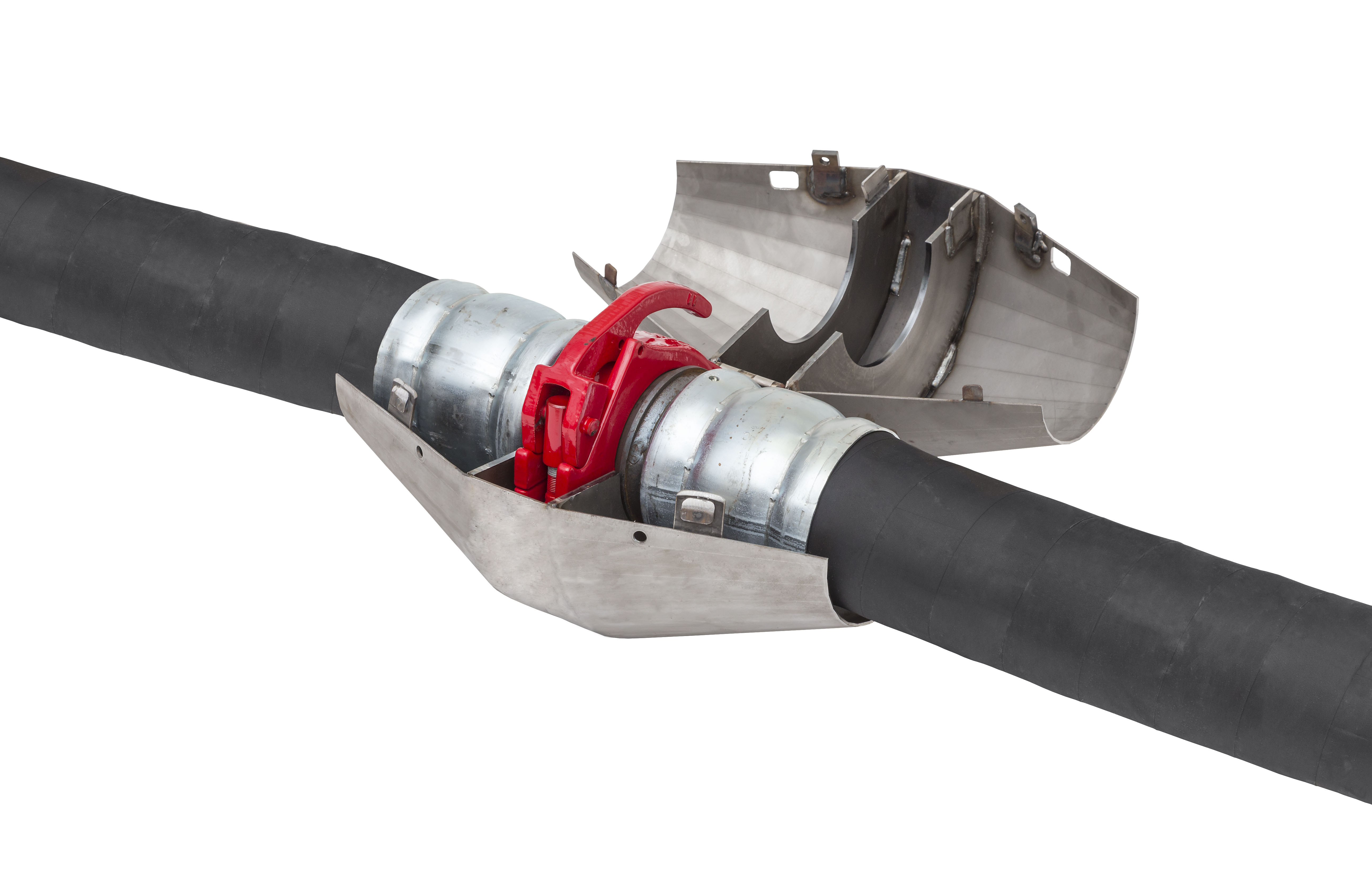

| Tank | 01-08-2015 | reply profile send pm notify |
Thinksnow We've had the Line Dragons on a lot of heat tube pours and never had any problems. We use to put pans under all the hose clamps but now we use the Dragon Egg™ As far as the tires on the Dragons, They wont hurt the tubes any. |

| ericICF | 01-11-2015 | reply profile send pm notify |
Tank are you going to have eggs for 2.5 and 3 inch ? We like to use "staple down" on outr tube installs and use 6x6x6ga wwm on top with brick chairs. Works good, and our locator saw never seems to find any:-) Never poured with fluid in them tho only air pressure. |
| Tank | 01-12-2015 | reply profile send pm notify |
Eric We hope to someday have the Dragon Egg for 3, 4 and 5 inch hose. We kinda decided to start with 4 inch and see how well they sell. Thank You Tank Line Dragon LLC 717-875-1153 |
