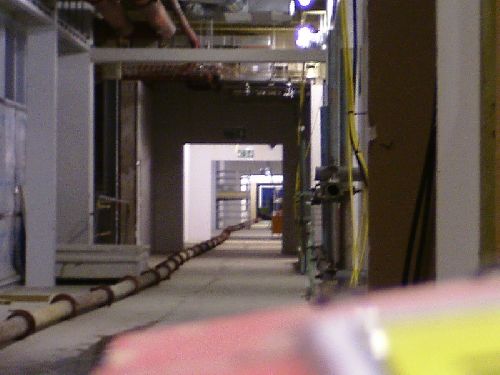

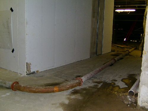

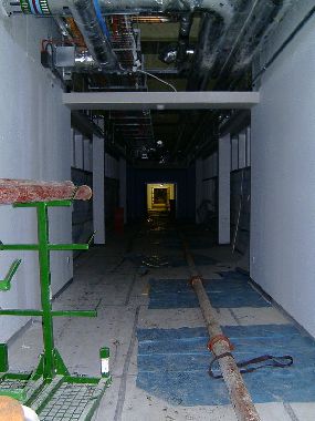

looking back up the line |

All that for how much concrete? |
| Seed | 01-31-2009 | reply profile send pm notify |
I was thinking the same thing. Looks as if the building is complete/ Could it be a 1 yard er? |

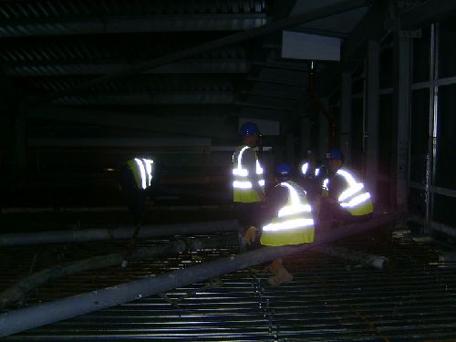

hi guys...80 cube in total...we had to break back 6 times back to the pump...finish'd 3 in the morni.... this is an extra to buliding.. |

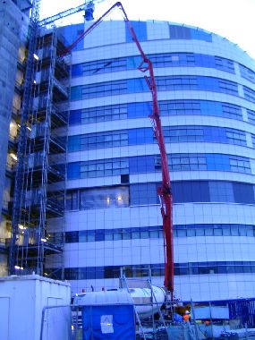

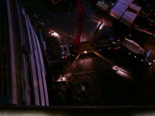

Those directional outrigger lights are sweet. From way up there that big pump sprawled out actually looks like a cat.......that went splatt! HaHAhaheha..... |

wow thats a real impressive amount of gear setup. did you blow it all out with air? must of been 5 yards of mud left in all that system? |

thats a long push cat! very nice overhead-night shot. those outrigger lights are sweet. |

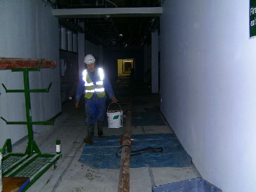

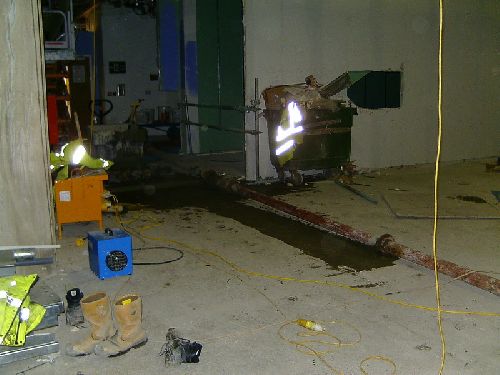

hi guys..the job is in birmingham a new hospital we had to empty every single pipe by hand..and believe me them 5" 3 meter pipe's full of concrete are not light...... |

Empty every pipe by hand? Wow, seems like you could have sucked back a sponge at least through half of that system. I've never pumped a big job like that. I would think a blow out cap at the end to assist the reverse pumping? What would you guys do? |

un able to empty the pipes useing a compresser due to the fact we broke back every 14 pipes with no way of blowing them...( inside a new hostipal glass every where )when we'd got back to the last pour we were only 6 pipes from the pump.... |

just me and another lad..3 of there lads help too...5 other lads in the concrete...still not a nice pour....but never mind all done now.. |

1 - 3m, 5" pipe full of mud = 200pds (give or take) equals a hard days work!!! other then pump operators, i have yet to see an operator get down and WORK. CUDOS TO YAH CAT :) |
