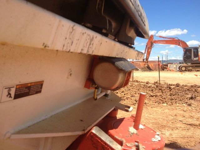

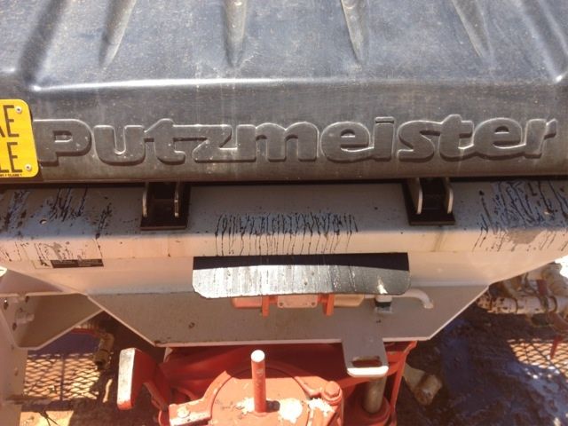

We run 2012 model 47 mtr putz here there's 6 of them spread over 3 jobs. All of them have rear mounted vibrators I have not heard of any of them having problems. Whe use a lot of 80 slump concrete where the vibrators are on all day
creamy 03-15-2013
creamy 03-15-2013
The rubber is an old piece of telebelt so the vibrator stayed clean
