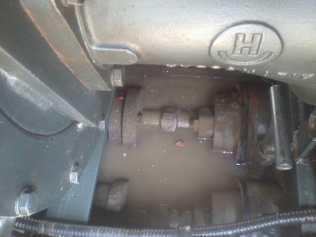

I´ve got an used trailer pump that worked ok last 6 months. Now it doesen´t. The problem is that it stops the engine like it was pipe blocked, but is not. 1. I´ve seen a problem of an "incomplete pushing stroke" of right plunger cilinder that over forces the machine, (I´ve switch R to L cilinder and the problem persists on right side. 2. I´ve seen that the main right Hydraulic cylinder works "sleepy" (video). 3. The main right cilinder on stand by mode started moving and "reached" the left cilinder (picture).
I dont have acces to Pm service but i need to do something, and I dont know what the problem is, how to find it and how to start looking for it.
Please look the photos and video and save me.
I´ll be so glad if someone can help me, thanks. |

prox switches,wires,acumilator blader,dead cylinder,closed 1/4 turn valve,putz.check your pressure ports for proper readings,could be as simple as a bad hyd hose worn on inside. good luck |

Sounds like the main ram is bypassing oil, either a broken seal or a scored bore. |

I´ve tried some cleaning job and changed the rings and seals of the main cilinders and the plunger cilinders too. The fact is after that no more leaks apear but the bad behavior steels the same. If the "cycle relay" is the one that changes from foward to reverse, it´s working ok, even so, when I change the flow, to reverse, the problem with the plunger ciliders changes of side, the one that doesen´t complete the stroke of the s tube is the other one, in this case the left one. In the video it´s true that the s tube looks to shift, but it´s so because position of the camera but the problem really happens, actually i´ve seen the s tube stopped in the midle.
