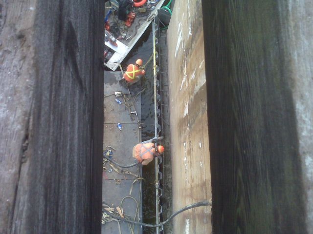

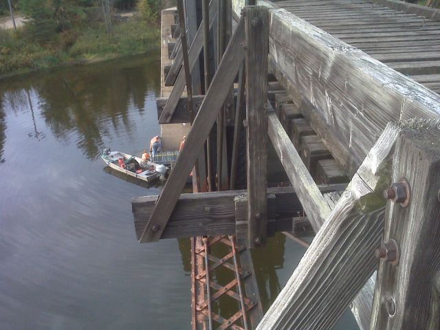

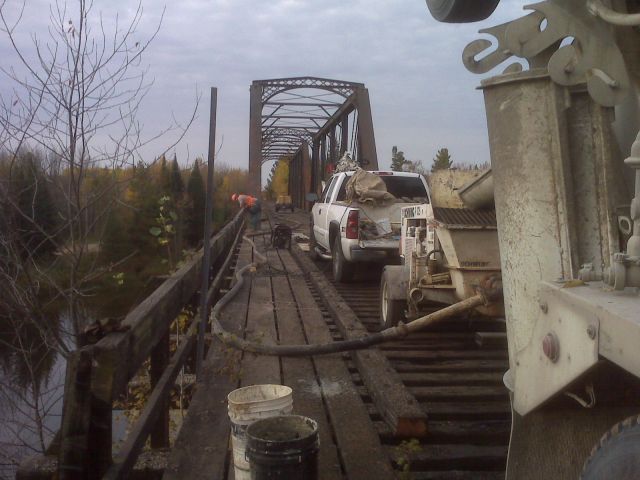

Ever get to a job that is way harder than what is said on the order? I got to this one yesterday suppose to be 150' of hose turned out to be 190 out then 40 feet down then 50' on the barge. All accross a rickety old bridge. 275 feet of system with a forty foot drop. Yeah i get there and two trucks are all ready on the highway. Lucky the small rock mix was good and my pump could push it. All went well.. |

Lucky i'm not afraid of heights, half the old boards were rotten. Don't lean on the handrail! |
