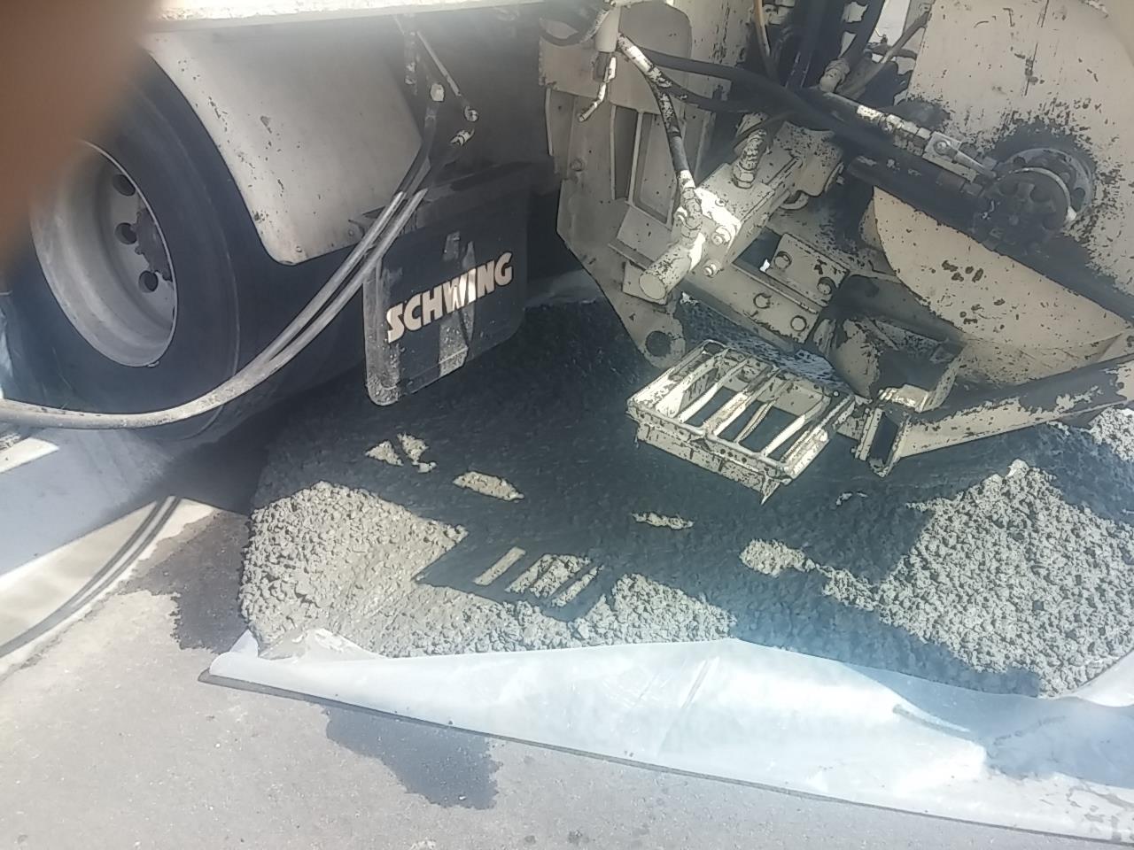

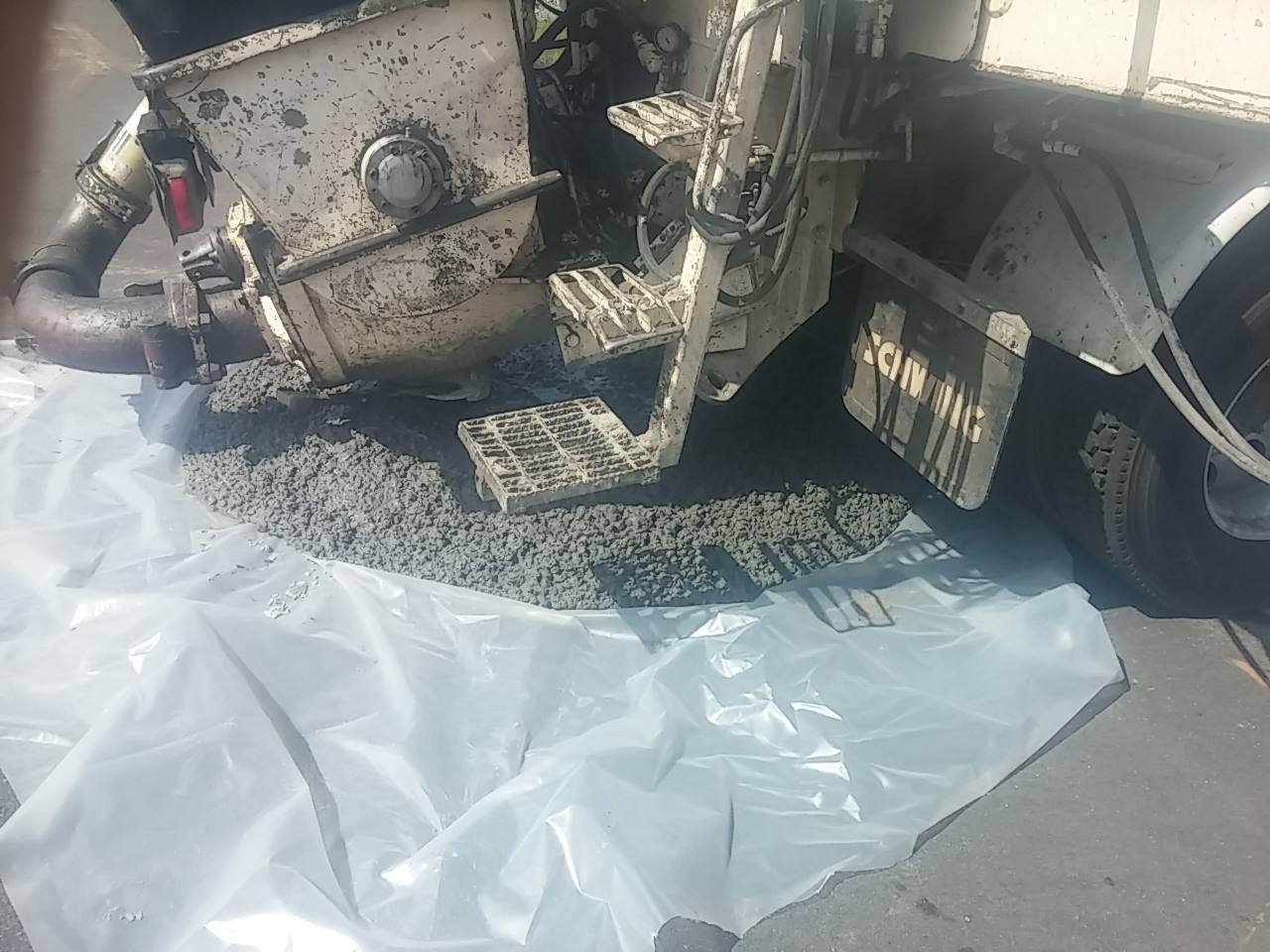

Pull up to the job doing two lots but the finishers started tailgating the first one so paid to sit and wait then a driver pulls up and fills my hopper with out priming out yet so i dumped it to get water in it then he refuses to clean it up....... oh well concrete companys getting a clean up bill

rofl rookie someone did put polly down. must be nice to dump concrete on ashfault though. since it on the redimix bill, send mixer away, tear down the pump, move to washout spot, washout, and start over with new mixer. made yourself an extra 1 made 1.5hr and no concrete on the ashfault. |

The chances of the ready mix company paying to clean that mess is slim to none. |

by no means would i have dumped me hopper on ashfault or tear down 'looking at the mud in the pic'. That being said, for all i know it may be all rock at the bottom of the hopper, or theres gold in the mud, or its another 20mins before the crew is ready. i wasnt on site and dont know what was going on. I just saying the days of dropin the hatch on ashfault and have no repercussions are done. Bad days happen and my tone heats up with the concrete, finding a way not to make shit worse cause shit happens. The Pump Gods are always watching. concords and jun-jin have the same top 45 (**dont open unless you personally have before, they dont all line up nice**) though id have gone through the trans door like rookie. clean pipes pime a long way. two spong will save the day. ***though never primed limestone*** trying to make a point to metro RMC is like expecting taxes to drop. |
