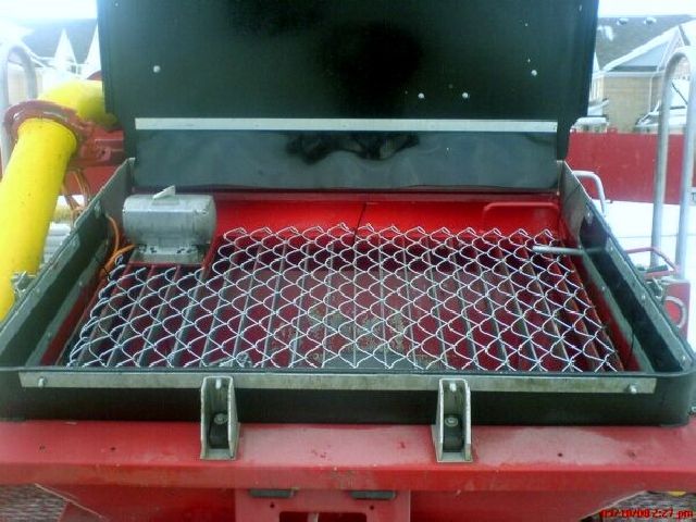

38zman 10-30-2009
I do this each winter and you have to run the vibrator but it has saved my butt more than one time and I only zip tie it on to the grate that way you can raise it when cleaning
driller 10-30-2009
WOW,that is one clean hopper
TooTall 10-30-2009
 Nice, Looks cool too, I like the cut to fit. I had a piece of chain link for a long time that had a black coating of some sort. I've tried galvinized but it just dont work the same, even tried painting over it.
 Maybe I'll try and stretch it out tight like yours see if the mud gets through it any easier?

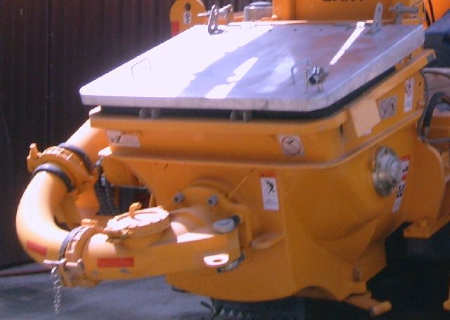

 Jus think Zman, You might have ended up with a hopper like this!
