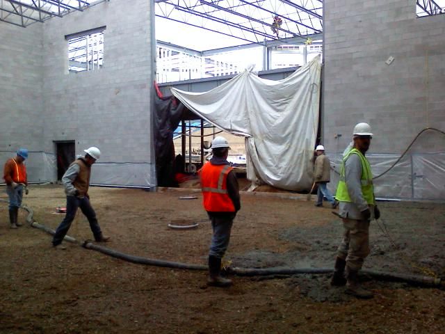

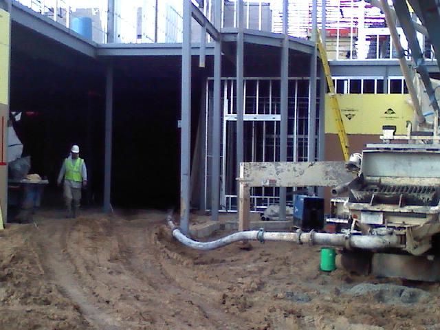

went back to the same job again today and found a different place to pump from this time i ran all 2.5 except for one 2 inch on the end and it pumped like a dream i also cut 150' off the system no clogs no drypacks just beautiful |
