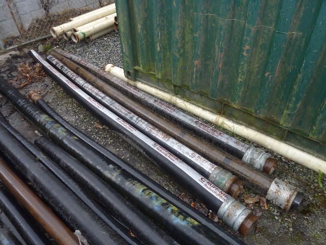

Dipstick 05-13-2010
Cool. never seen those before in europe. But I can imagine quite quick that this is the most dangerous thing you can hang on the end of your boom. Really not well thought about.
Dipstick 05-13-2010
Sorry but if you can't see why your hose is bad and your actually proud of it... I think people can't trust any of your opinions or products.
