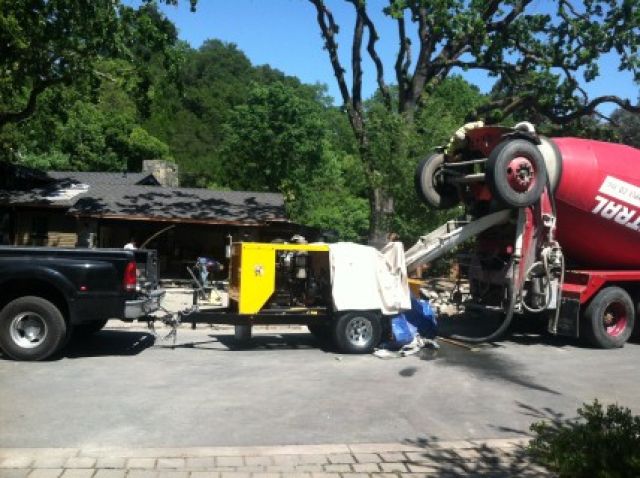

| pumpSHEP | 06-13-2012 | reply profile send pm notify |
I own a reed a30hp and love it. It pumps great, and really simple to work on. I just did a 475 ft job slightly up hill yesterday to a retaining wall with no problems and plenty of power. Priming out is simple, fill up the hopper with concrete pour 3-5 gallons of water mixed with EXTRA HIGH YIELD BENTONITE into the reducer back towards the pump. Then put a half gallon of water in the hose connect it and go. I have rarely ever plugged under 300' this way. Dont pump the slurry mix into the job, put it back into the 5 gallon bucket.
The mix is the most important thing to know. What size hose you are going to use. In northern california we have everyone using a 6sk 50/50 mix that puts out 3,000 psi and we use a 2.5 inch hose. Pumps like butter.
Becareful pumping some pea gravel mixesin you 2" hose, if its a exposed mix it will be really heavy with rock, requiring you to use the 2.5 inch hose.
As far as 3 inch hose and 4 inch, I only use it for special mixes that are required for state jobs. Other then that stick with your customer using a blend mix (50/50 of 3/8 and 3/4) |
