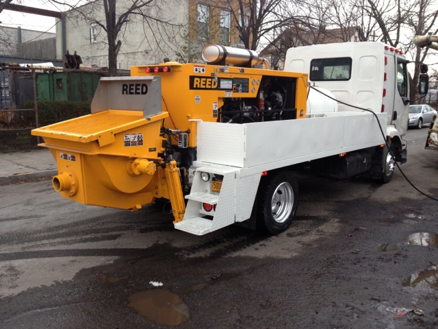

REEDPumps 03-25-2014
and here's the view from the street
