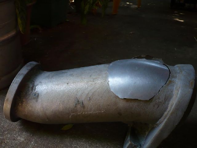

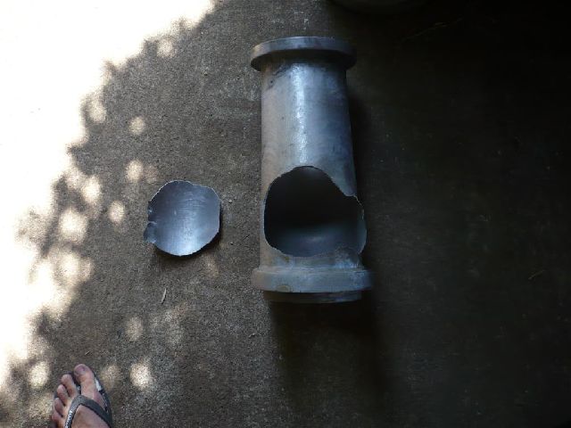

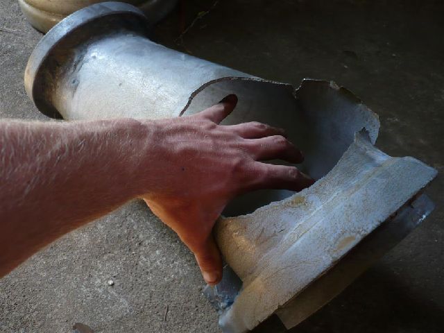

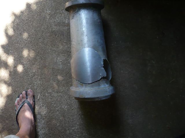

Hi, Had a bit of a problem at work yesterday but thankfully we were pretty much done with the house slab. Had a bit of blockage(concrete in the hose dried up a bit and the pump was pushing it out at approx 1500-1800psi when this loud bang and the hopper being rattled around a bit, scared the aggi driver and myself. This is what happened.

I'm confused what they are called, I think it's Rock Valve since I was told that but I've been checking around it seems like it's S-Tube. Could someone confirm this for me please.
This is on a Line pump, not a boom.
Thank you.

it's fucked, that is what it is, lol, sorry Todd, it's a broken piece of s tube, not much meat there, she's done some work.
biged 12-10-2009
Man that was getting thin no repairing that baby better check other parts for wear while fixing your pump.

 Yeah that is pushing an S-tube a little far. Schwing has the rocks. What I dont like about the S-tubes is there isnt enough room to put hard facing inside it.

I do belive tou got all your dollers worth out of that tube a little maintanence and inspection will help you from having those kind of oh shit situations

Oh yea, we had the pump stripped down, inspected about 2 months ago, was told it was all good to go! I knew it was beyond repairable, it'll be sitting in the shed as a trophy! Have a new S-Tube in now and back pumping again!
As far as I know this is probably the 2nd S-Tube on this pump over the last 5 years.
